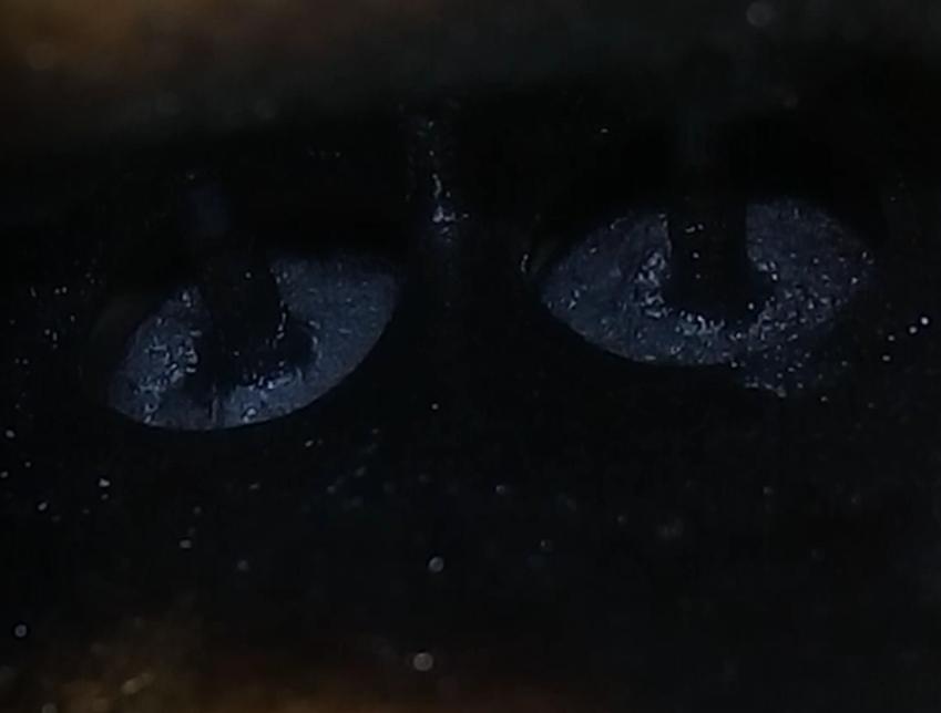

Anyway, I've just done the PCV Mod, and have ordered a borescope and intake gasket kit to see how bad the car is. I hope it's not too bad, but expect it to be ugly.
My plan is to remove the top plate on the Intake Manifold (inspection cover?) and have a look at the Intake Valves.

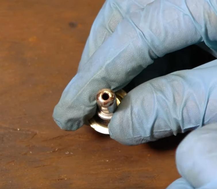

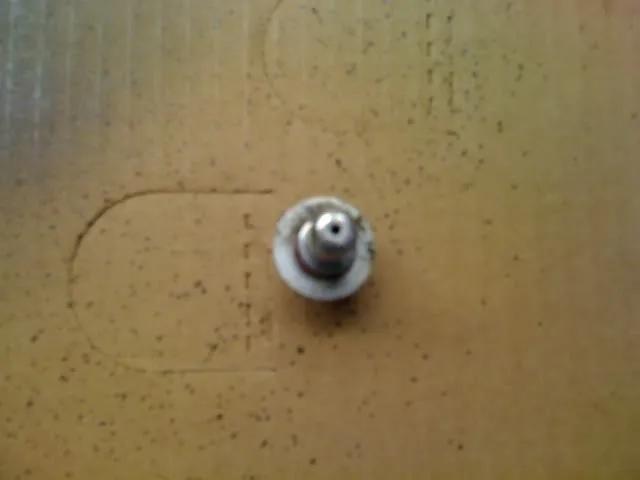

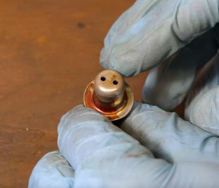

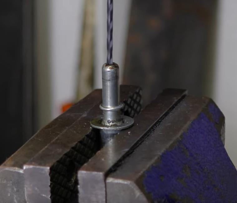

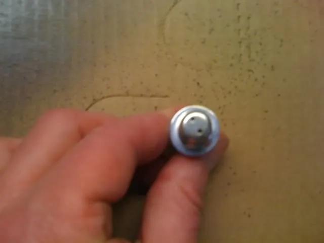

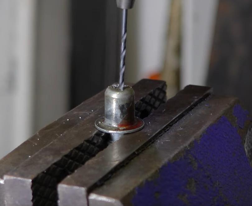

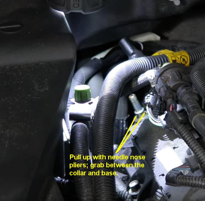

PCV MOD, is for 10-11, and early V6.
Pull the PVC out of the valve cover.
Drill the bottom holes to 5/64th.
Drill the top hole to 7 to 9/64th.
When I pulled mine, one hole was clogged, and the other was close to it.
There is no check-ball or spring, it's an open orifice device.
These are how small the bottom holes are:
TOP:
Later 2012-2014 TOP:
HOW-TO:

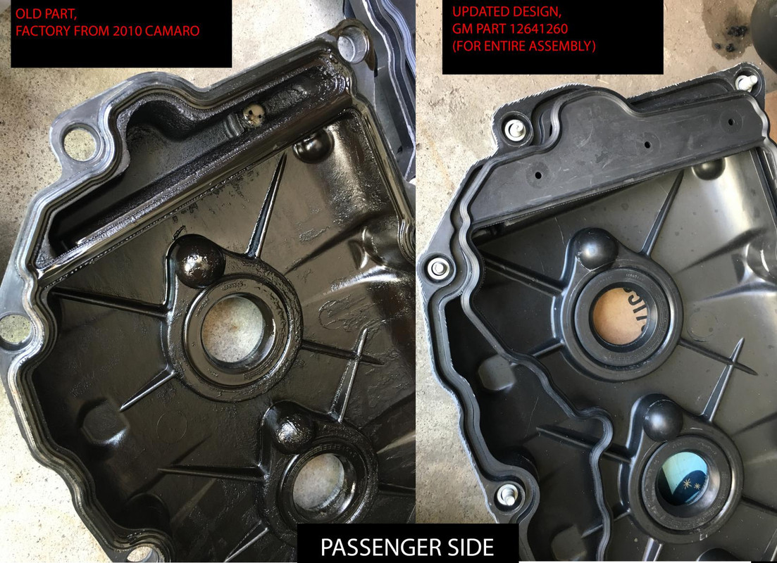

There is also a new Valve Cover gasket for the passenger side that closes off that big area under
the PCV:
That greatly cuts down the oil consumption through the PCV.

Great pic of the "new" valve cover.
Thanks for the info, very helpful.
Thx

I've already done the PCV drill mod. 7/64" top and 5/64" bottom. I'll try to link pics ...

It's not a new Valve cover (Cam cover), but rather an updated cam cover gasket. Notice the 3 small holes to limit the amount of flow through the PCV circuit.

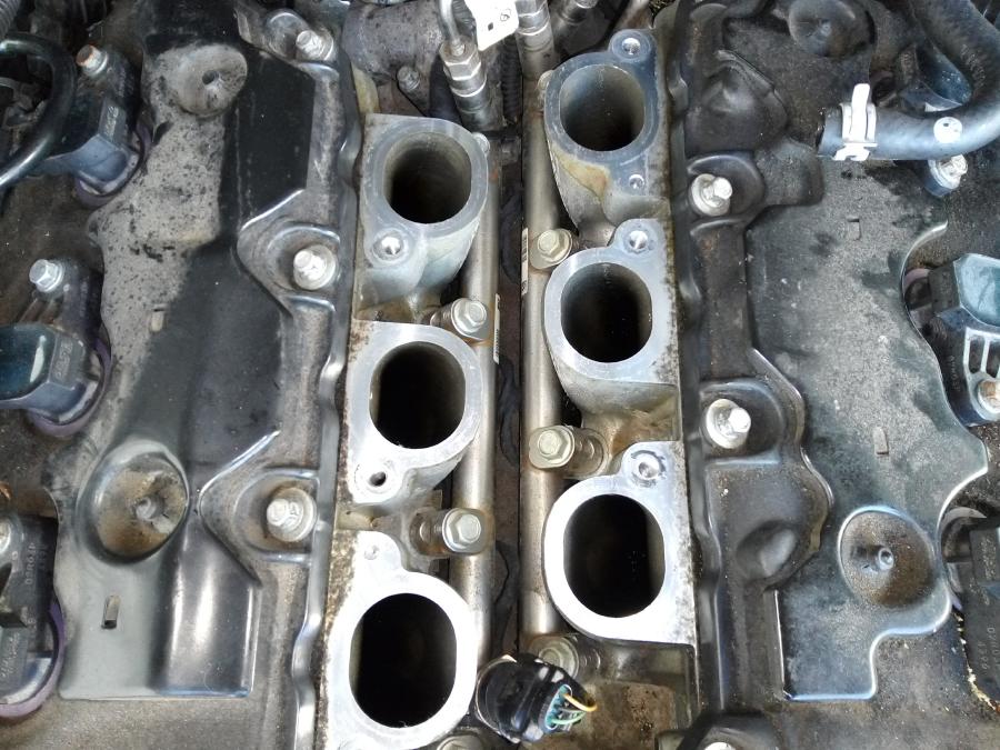

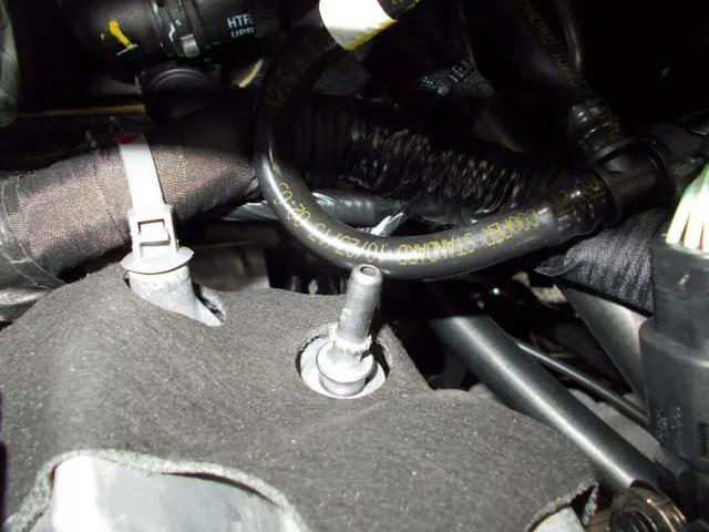

This is my Wife's LLT before and after I did the PCV Mod
Sorry for the MONSTER pics. I'll work on that next time!!

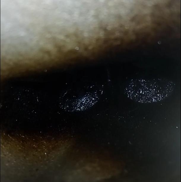

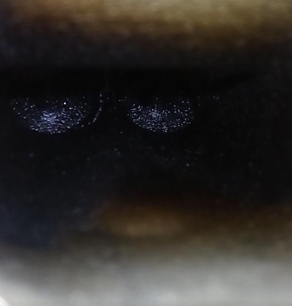

Here's the Intake pics and some disappointing Intake Valve pics. The borescope I bought was cheap but does the trick. The pics are terrible but show I need to re+re the intake and manually clean the valves.
After viewing the Valve pic online I see it's not worth anyone looking at.
I'll post clear pictures once I have the Intake Plenum off.
Probably not for another month or 2 as I'll wait for a nice-weather 3-day weekend.
Again, sorry the valve pic is crap
