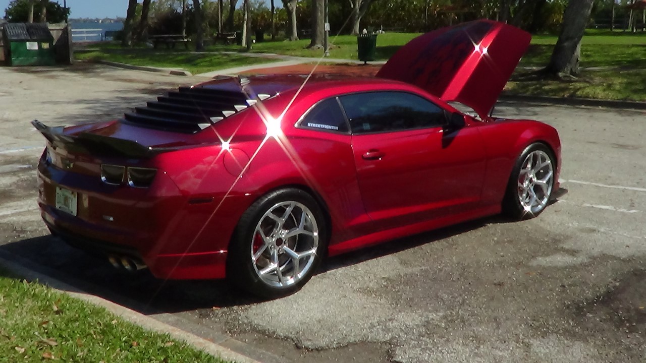

Stock on the ZL1 and the 1LE and Z28 are 20x10 front, 20x11 rear with +23 front and +43 rear and will fit on your Camaro..MY FRIENDS 2014 SS with the Z28 wheels.
Name:  Roberts Camaro.jpg

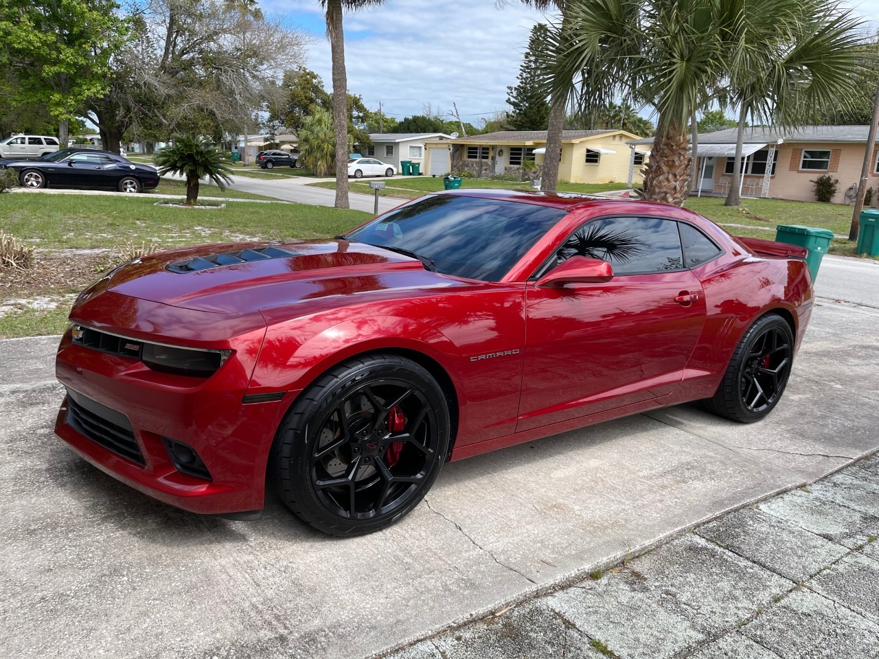

Here is mine in polished and cleared.
