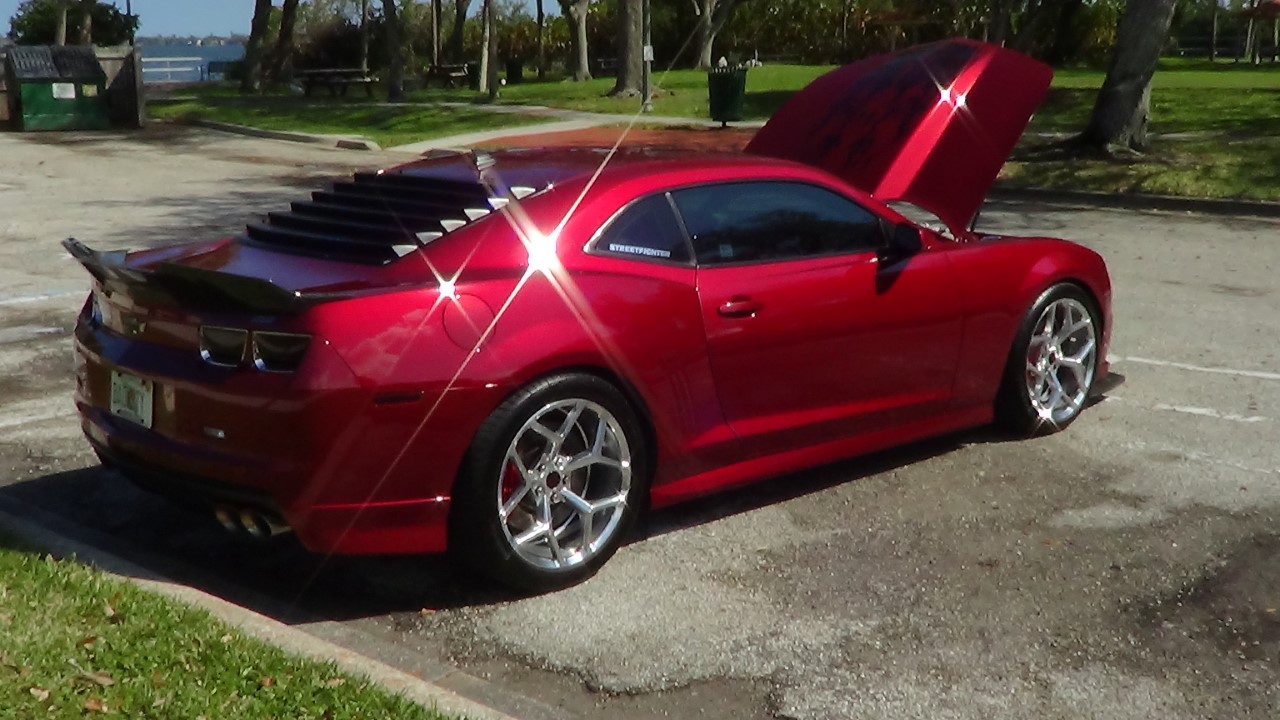

Damn man that's nice bro!! And I am the same way with the ceramic's, don't care for them. My Camaro is 11 years old, built in mid 2010 for the 2011 model year, a daily with 122k miles on her and no garage to keep her in. It's all in how you take care of her from day one!! I had the car buffed and sealed back then and kept it up from then on. I used to use McGuires products, loved them until I tried some of the Chemical Guys products, man what a difference. One of my friends has a 2013 ZL1 that was ceramic'ed and my 2011 with just the waxes and sealants id just as shiney and glowing as his is. His is Crystal Red Tintcoat and mine is Red Jewel Tintcoat. You look at both cars side by side and you can't tell which was coated and which was waxed!! Love it. Here is a pic of mine after a 4 hour detail with the Chemical Guys sealant and wax. The second pic is from last year, same products, just not much sunshine that day. lol.
