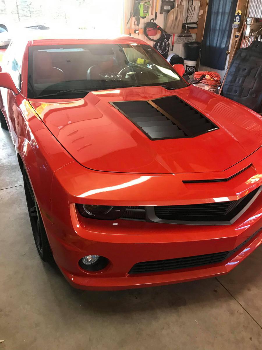

See a lot of people are wondering if they should go turbo or centri. I love my little D1X, I like the simplicity and it’s definitely a head turner. Just a short rundown on my build. Forged bottom end, 416 CI, Holley hi ram, long tube headers, TFS 255 heads, AGP fuel system, Cam Motion blower cam, runs on 93 and E85. Really fun street car on 14 pounds. Numbers would’ve been a little higher without the R888Rs on it, still a 2.5 inch exhaust (ran out of play money for a 3 inch) and I’m still running the small procharger intercooler but I’m happy with it for now. Pulls hard, great street manners.
849 rwhp and 723 torque

Your 2.5 exhaust set up answered my question if how bad itll be leaving cat back stock for now with a centri Looks to work up to 800hp lol
EDIT* Could i see a better pic of that hood vent? It look good

2.5 inch exhaust is fine at 800 hp although he did say with a better/bigger intercooler and 3 inch exhaust I probably wouldve been a lot closer to 900 rwhp. Its not ideal but it works.
