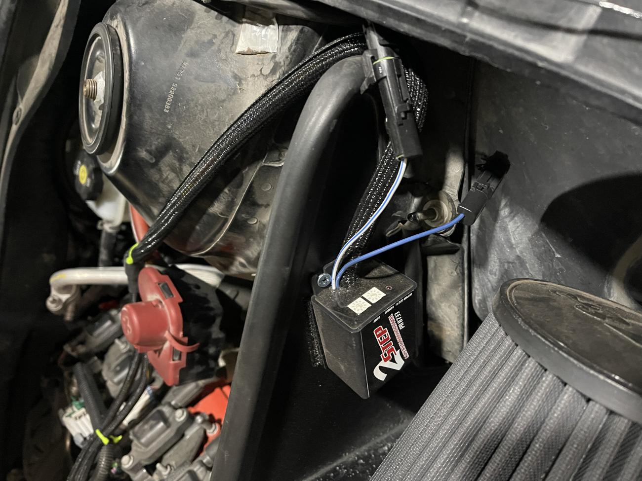

I have mine setup as option 2. I have the Hurst line lock and the msd 2step. Wiring was pretty simple. But I only use the 2 step for launch and not no lift shifts. I only drag race one night a month in the summer for the street legal drags haha. Currently have the trans pulled and getting built and upgrading the clutch setup. That’s why you see no shifter in the pictures haha

It’s technically armed the whole pass. I hold the momentary switch by the shifter at the staging lights. It activates the 2step and line lock. When I launch I release the button therefore releasing the line lock and 2step. Technically everything is still “armed “ but unless I hit the momentary switch nothing will activate. I also have a “master” switch that disengages everything so I don’t hit the button with my knee when on the street.
The toggle switch by the headlight switch is just for arming the 2 step.
