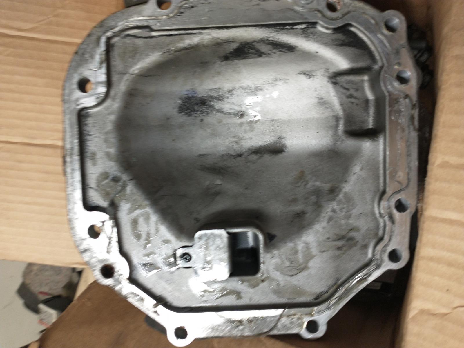

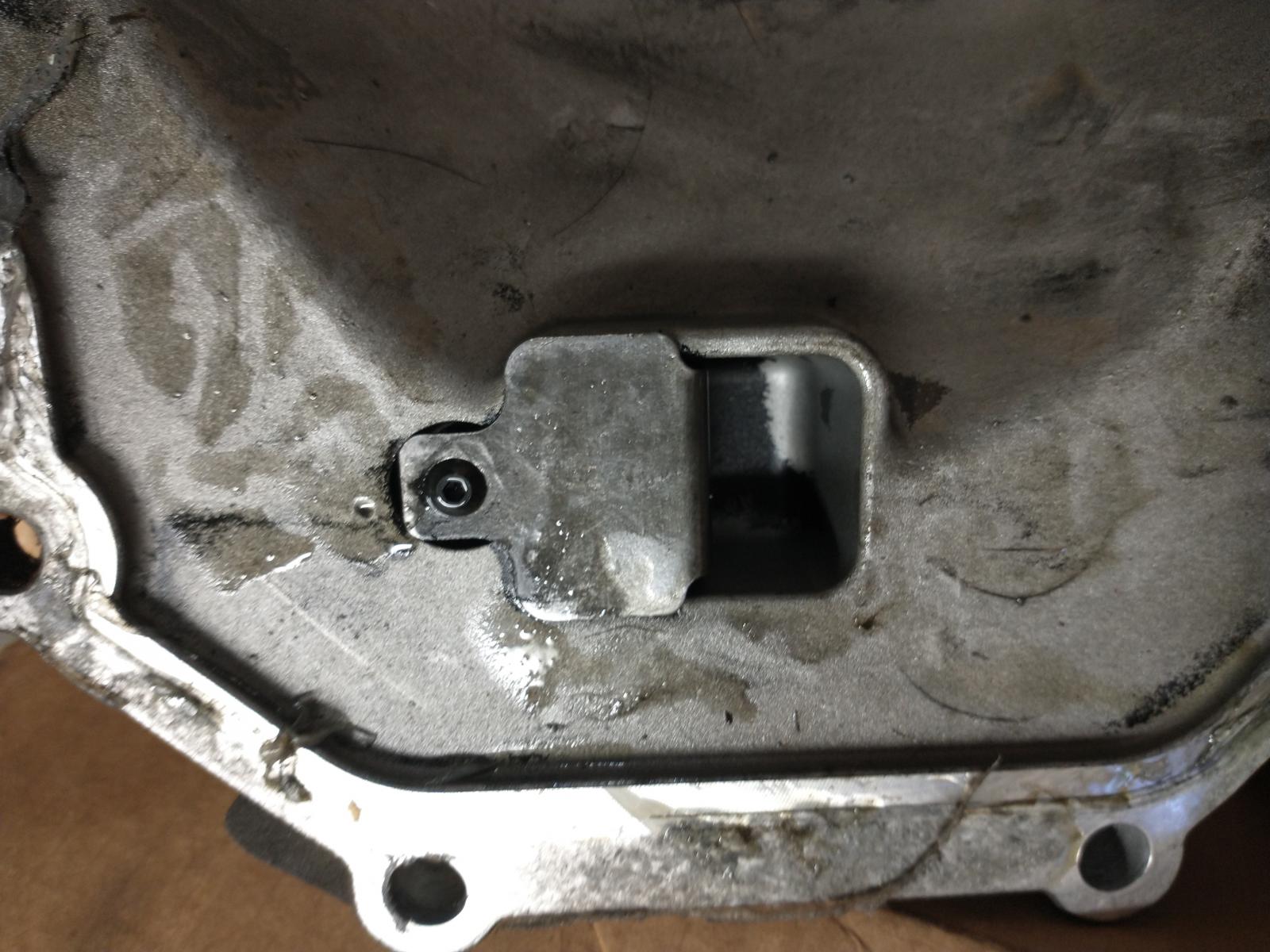

A main piece of info I'm looking for is on the breather tube (with/without one way valve?) and it being a possible root cause I need to eliminate first.

there is a baffle inside the diff cover that keeps the oil out of the breather tube...so I doubt that is where it's coming from...
I literally have my diff laying on the floor off my garage after having blown out the posi unit...waiting on my Truetrac I ordered from DynoSteve to show up...then back to the drag strip....yea haw!

Thank you for your view on the breather. Could you please take and post a picture of said baffle? I'd love to see what it looks like.

Ask and tho shalt...
so unless the diff was overfilled I don't see how any gear oil would make it up the breather...
fyi...the pic's need to be rotated 90 deg to the right for correct orientation...

You're right... and it doesn't make sense for that passage to become obstructed, either. Can't see aything make its way up there that could block it. Doesn't seem to have a one-way valve either. I've read that this could cause moisture in the environment air to enter the diff and dillute the oil. A matter of cheaper design, perhaps... But at least that valve can't be blocked if it isn't there
Thanks for the pics!
