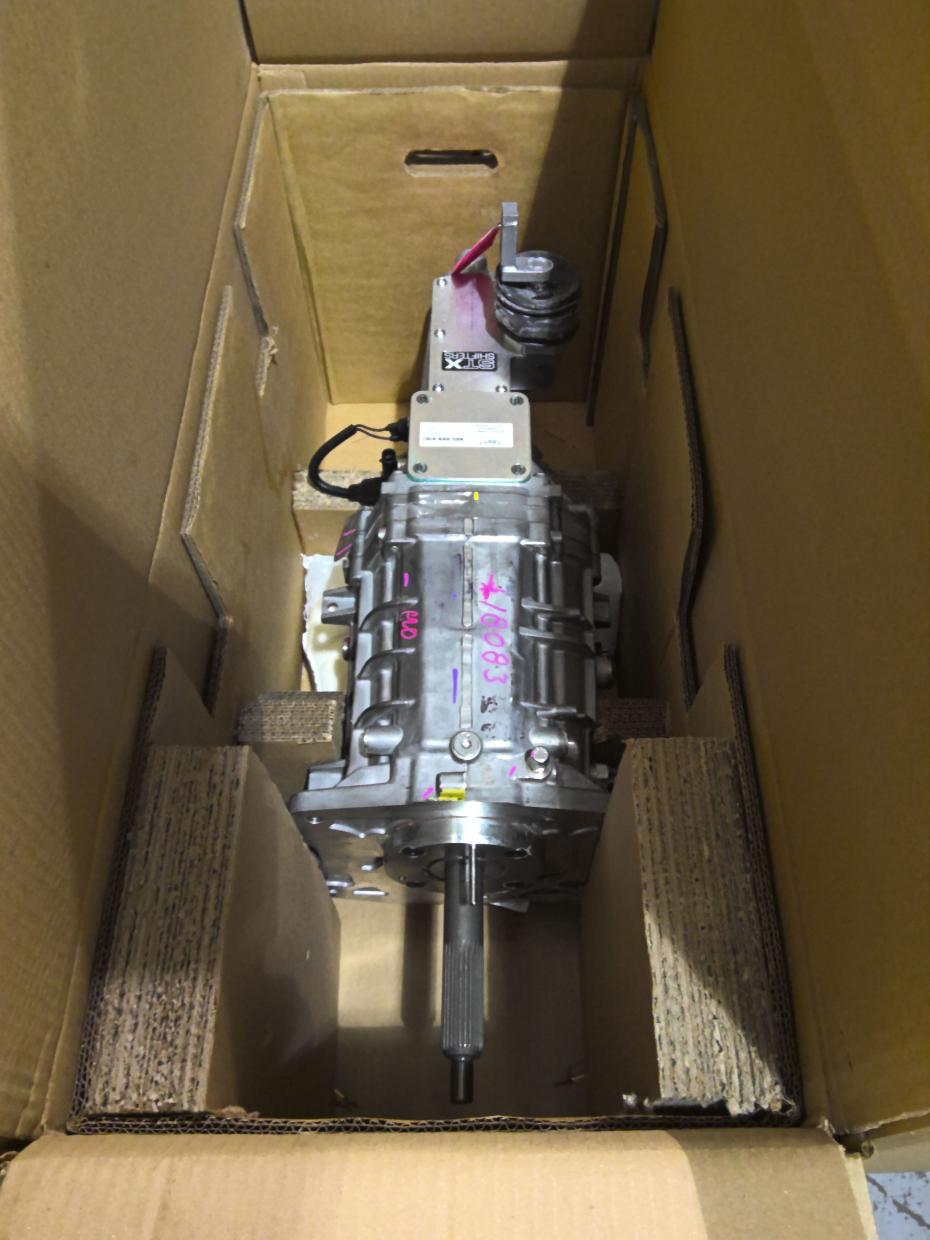

In the end, it's not a TKO but an improved TKX.
It's already on its way. It will break out in a few months.
With this transmission, it will be quite a comparable car to the 2010 SS LS3

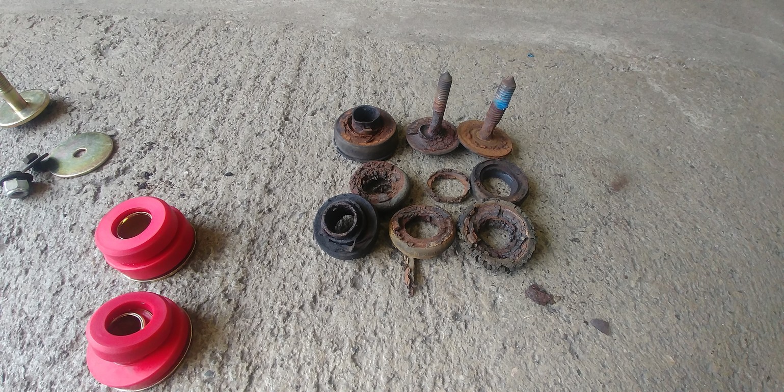

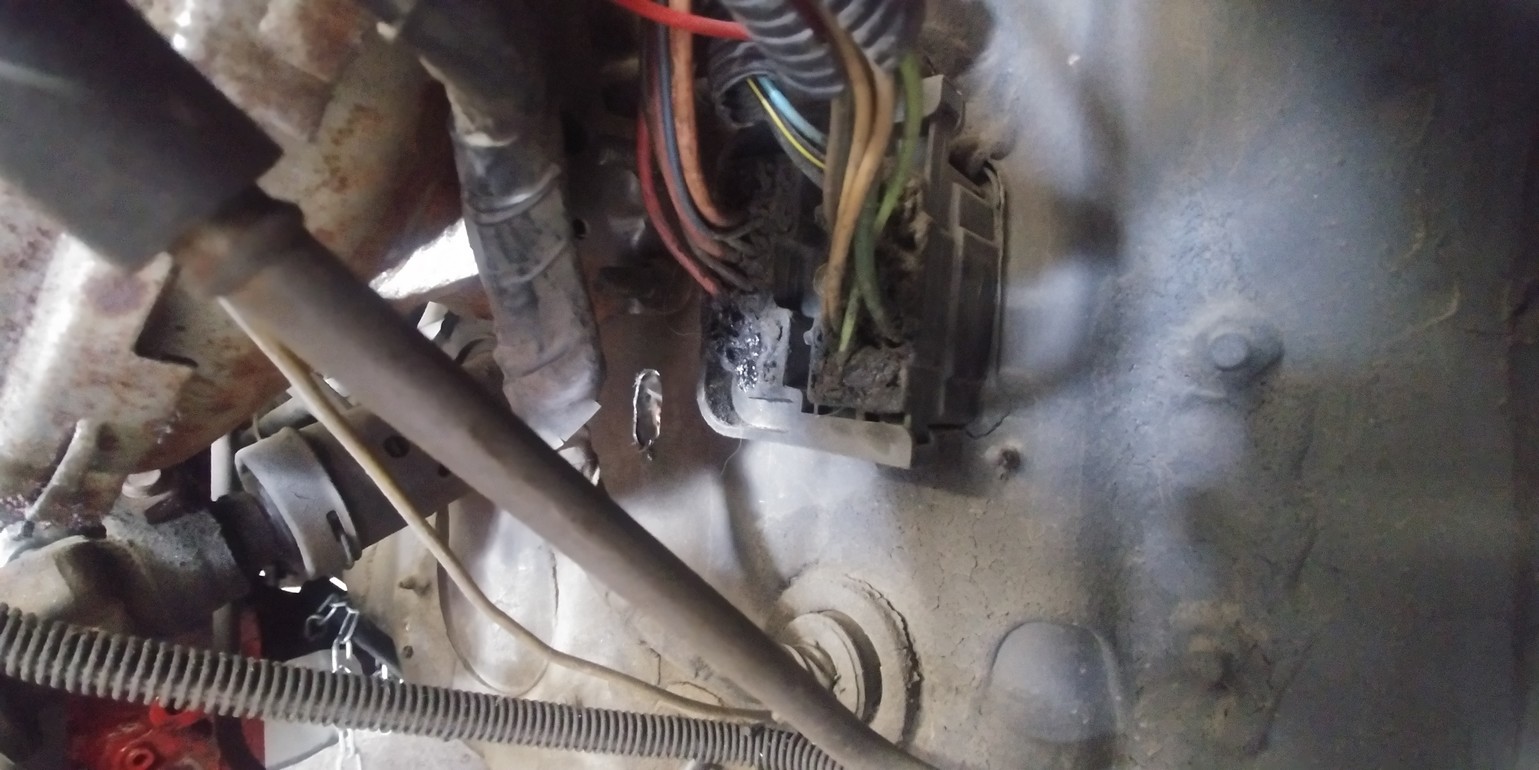

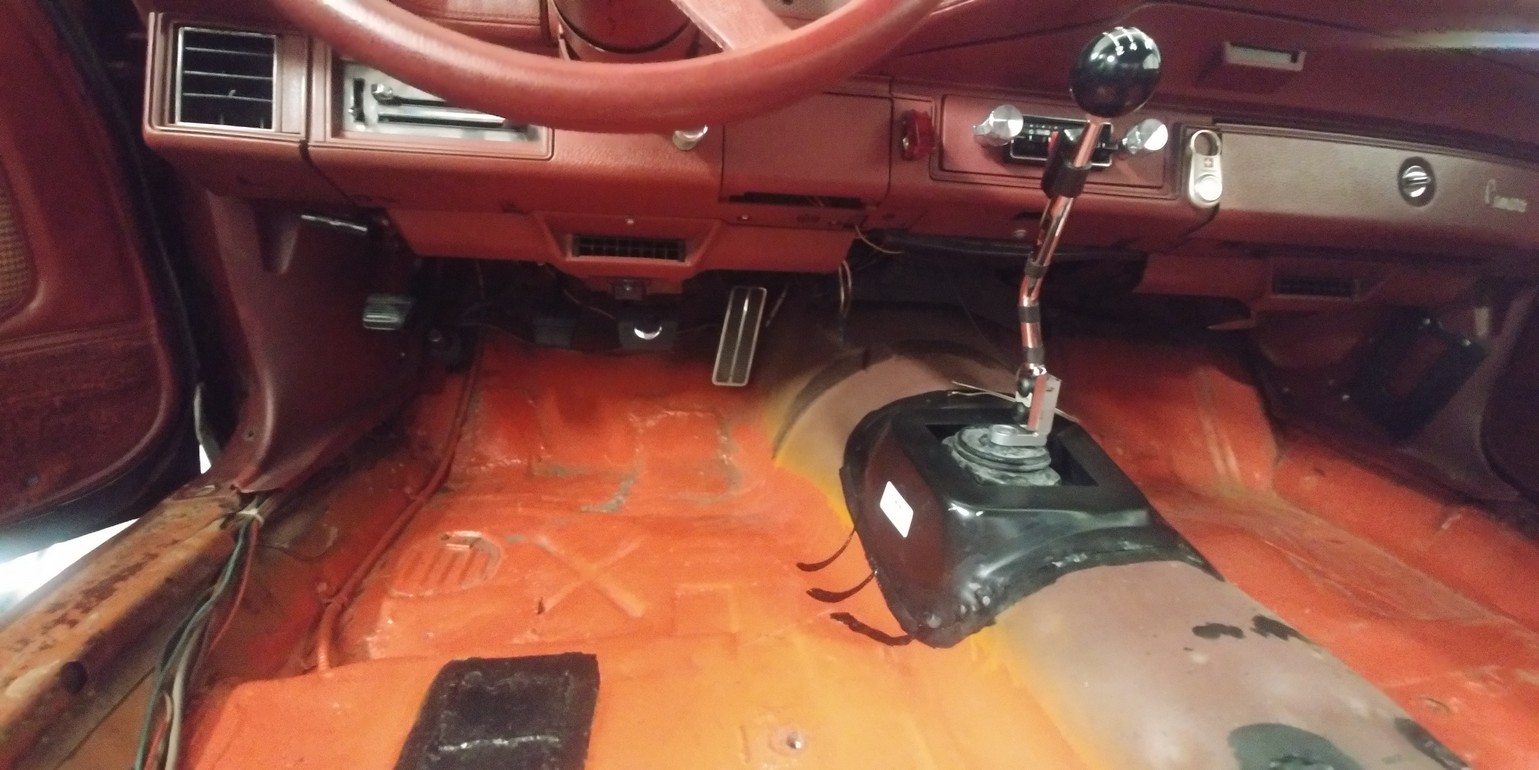

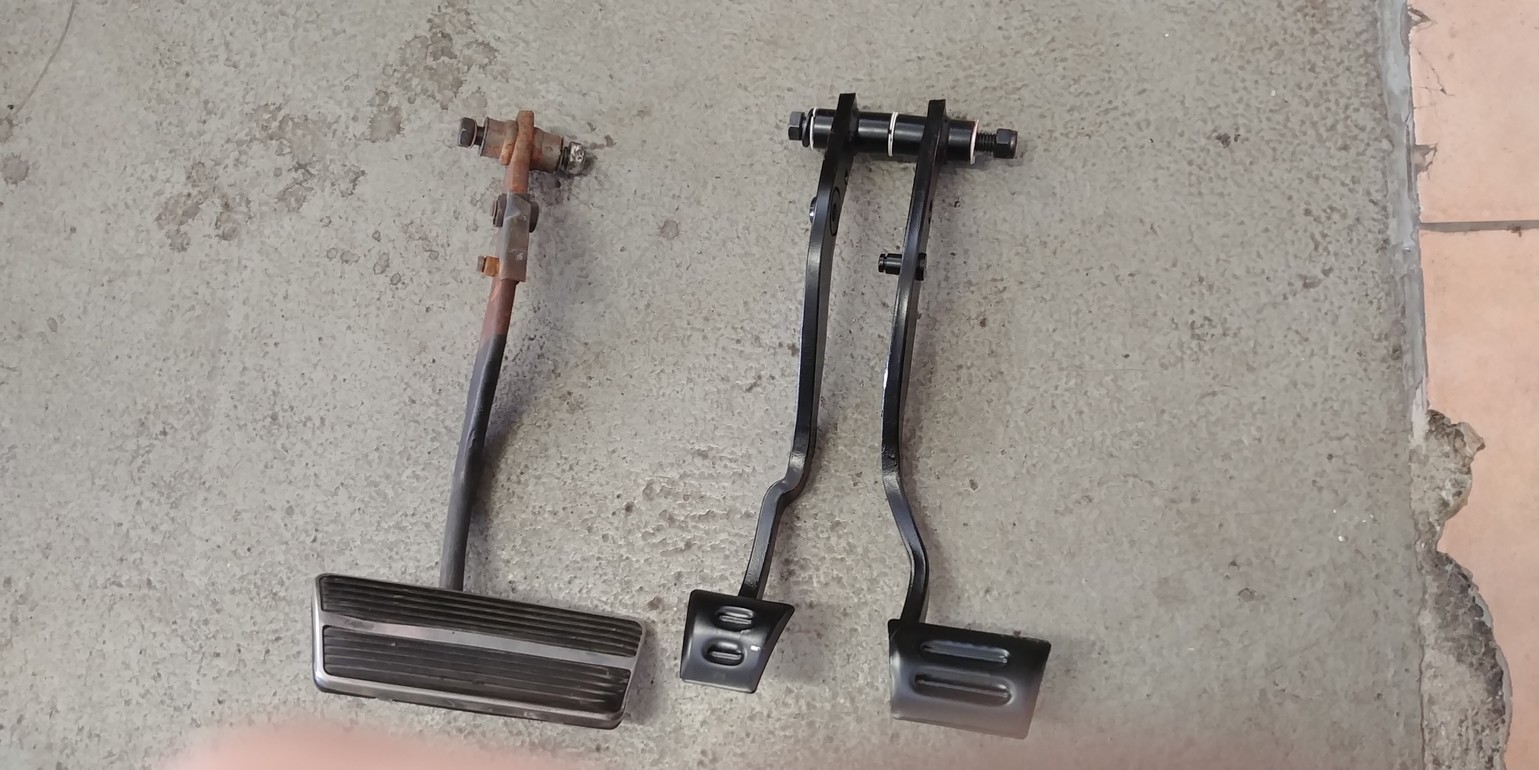

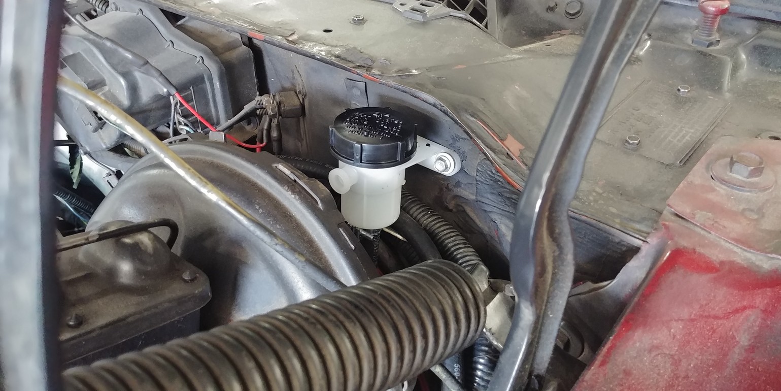

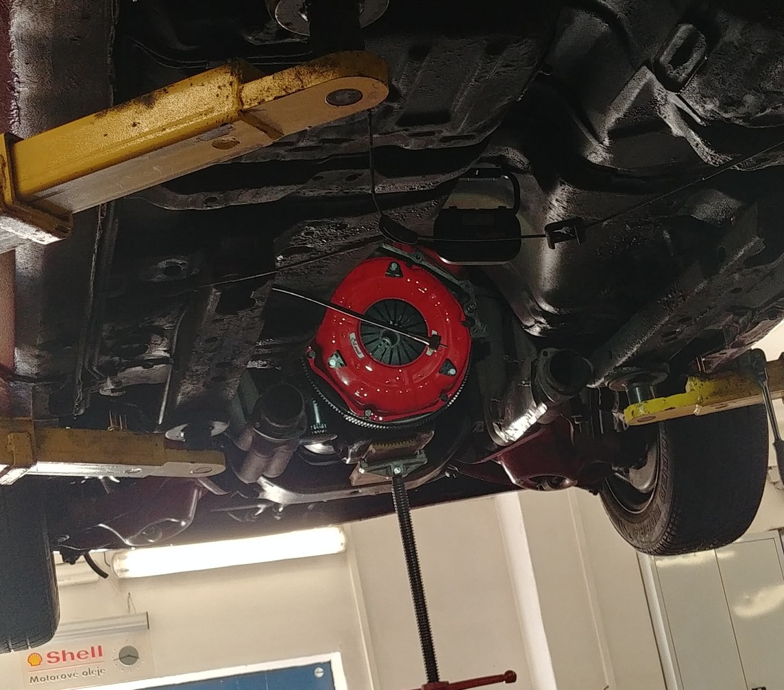

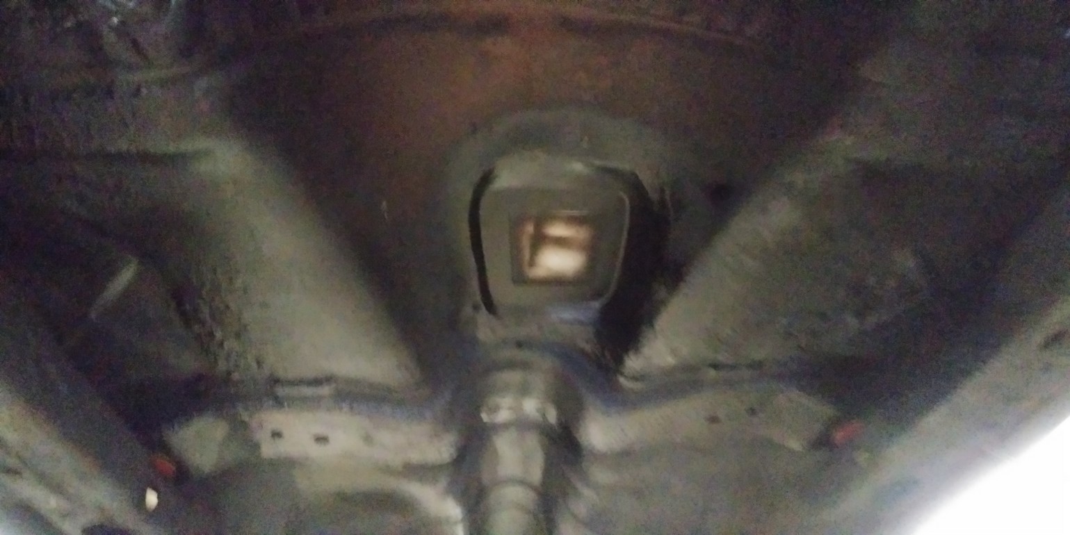

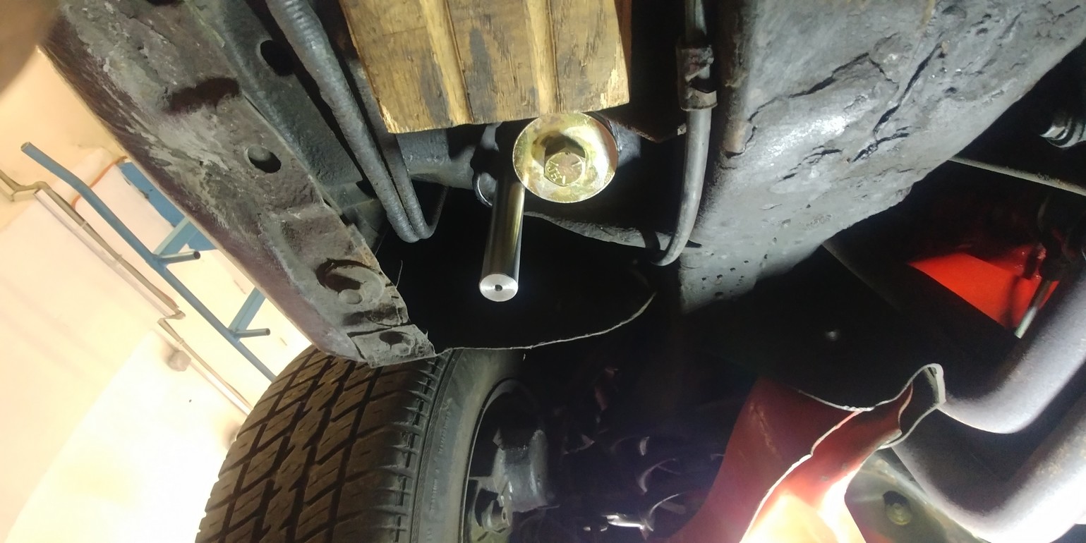

So I got down to it.

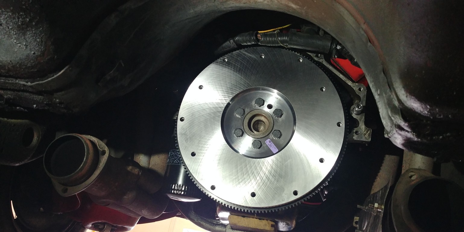

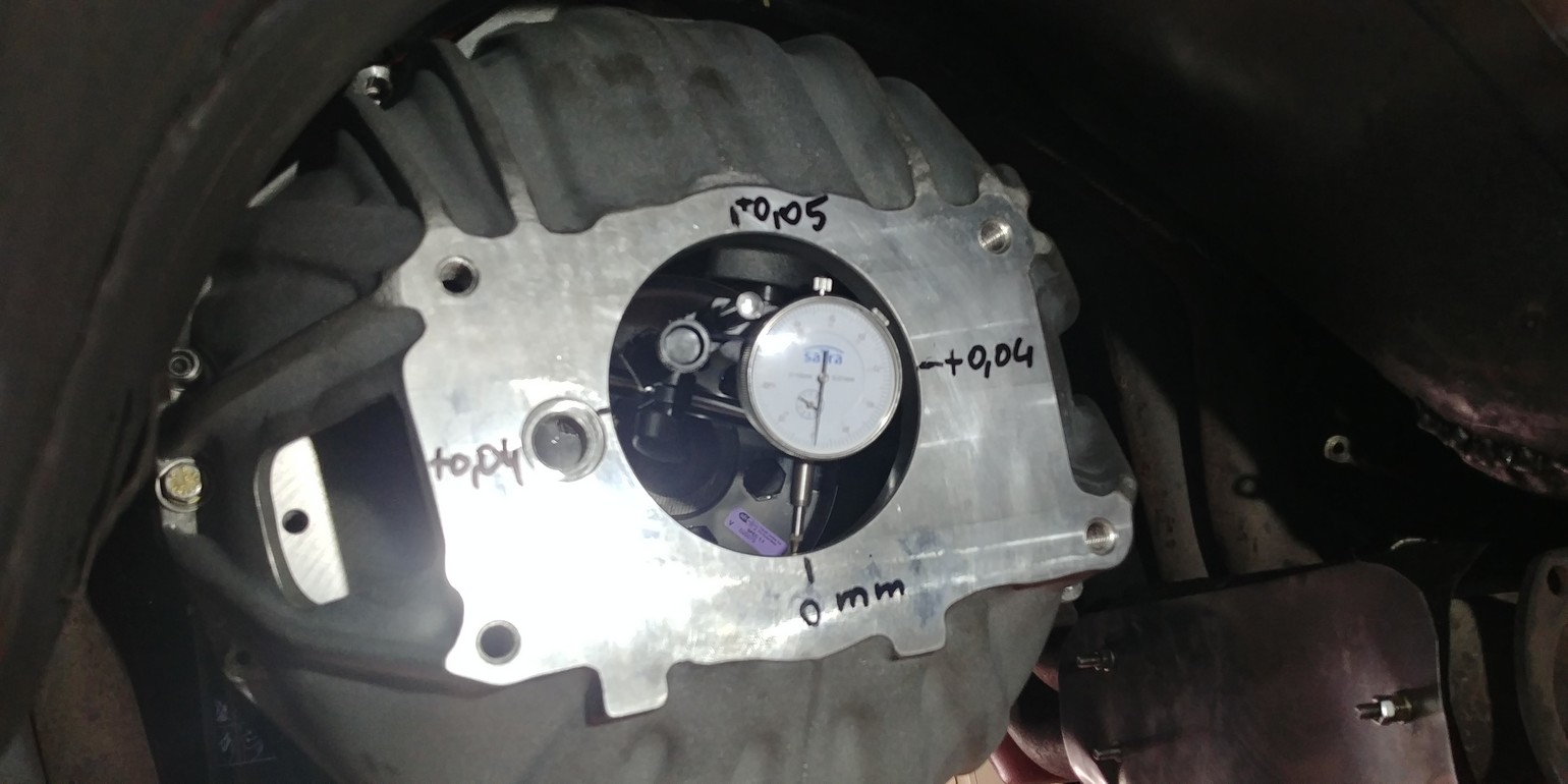

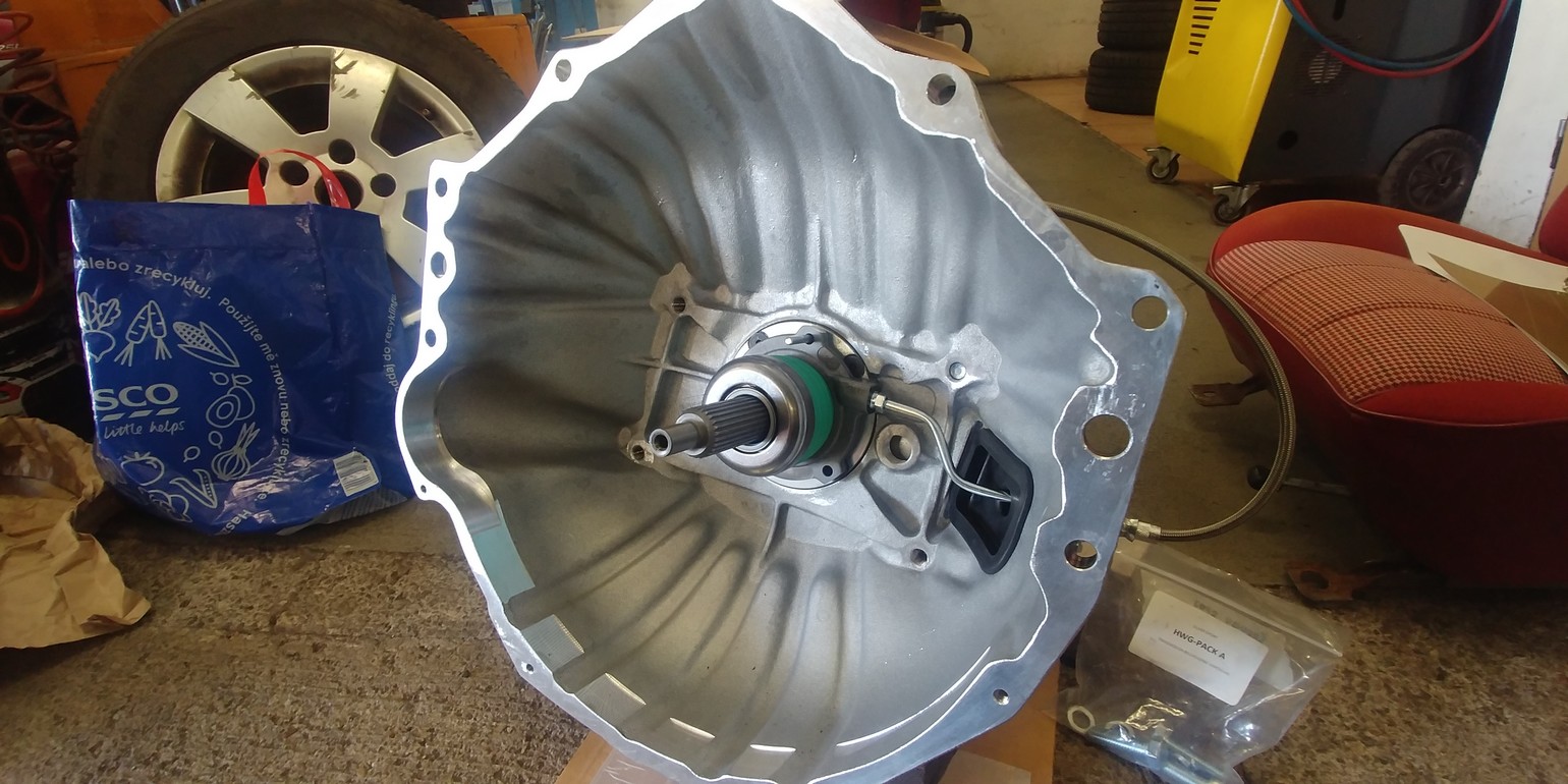

That's what I'm struggling with right now
But it's poorly designed when it has to be bellhousing taken off.
Now I'm missing a tiny piece to tolerance and it's clear to me that I'll take it off and reach for it, so I'll throw it all away again

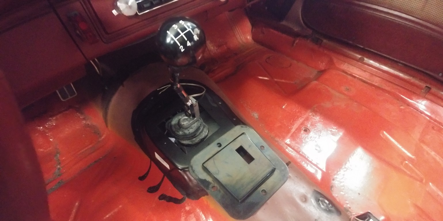

Posts: 1,611

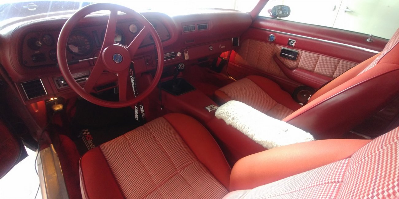

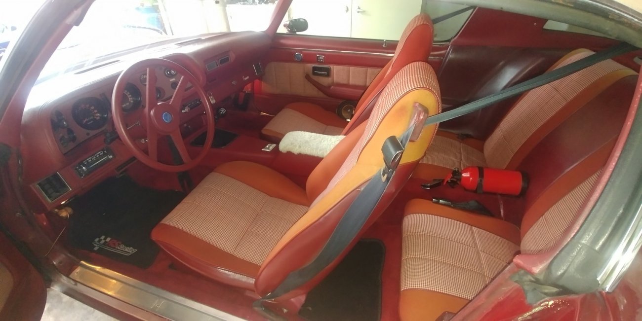

The rest of the photos...

Originally Posted by Stingr69 View Post
How far off was the bell housing alignment?
I used .007 pins and I'm under half of the given 0.005-inch tolerance.
I am at zero in the horizontal axis and five hundredths of a millimeter in the vertical.
