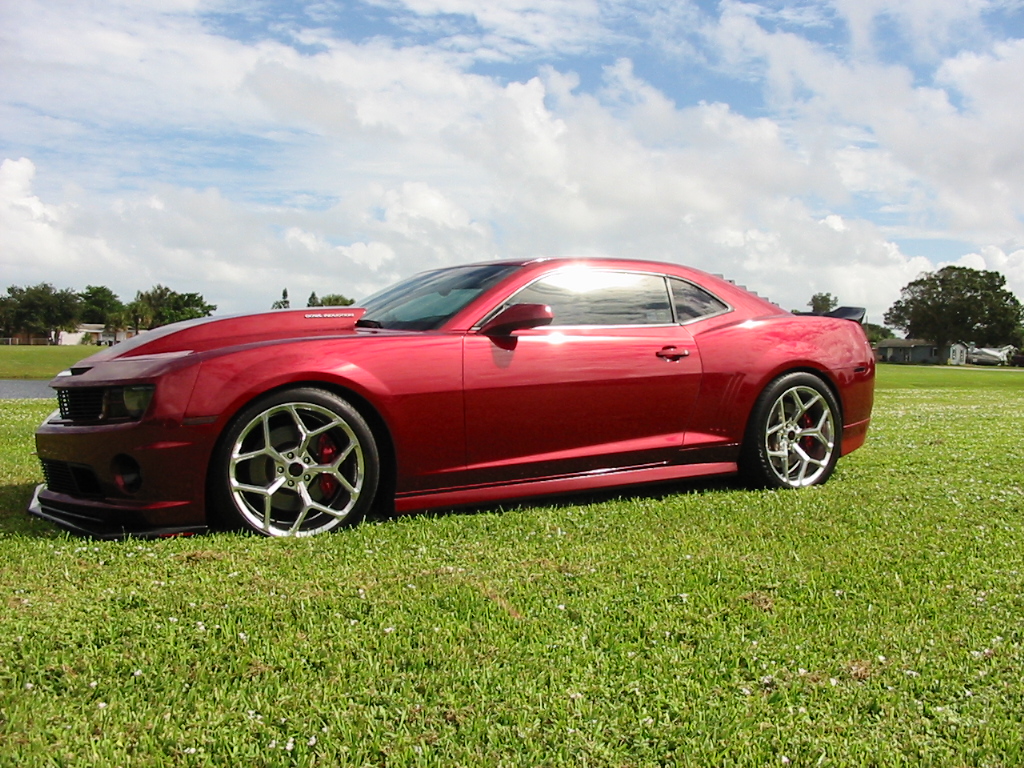

If you are looking for OEM Z28 wheels, good luck with that! If you do find any, and they are hard to find, they are going to cost you a pretty penny!! Phastek Performance or MRR Designs offers a "replica" of them for a great price. I got mine, when I had them from Carlos at MRR Designs and they fit perfect, no poke at all. 20x10 +23 front,, 20x11 +43 rears. Here is a pic of them.

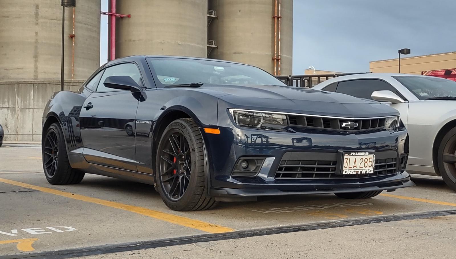

No shame in that. Most of the time 19's are going to be lighter than 20's, and removing unsprung weight helps with pretty much every aspect of performance and ride quality.
I'm running 19 in. Apex ARC-8's for my summer set. 10's in front and 11's in back. 295/35/19's all the way around.
