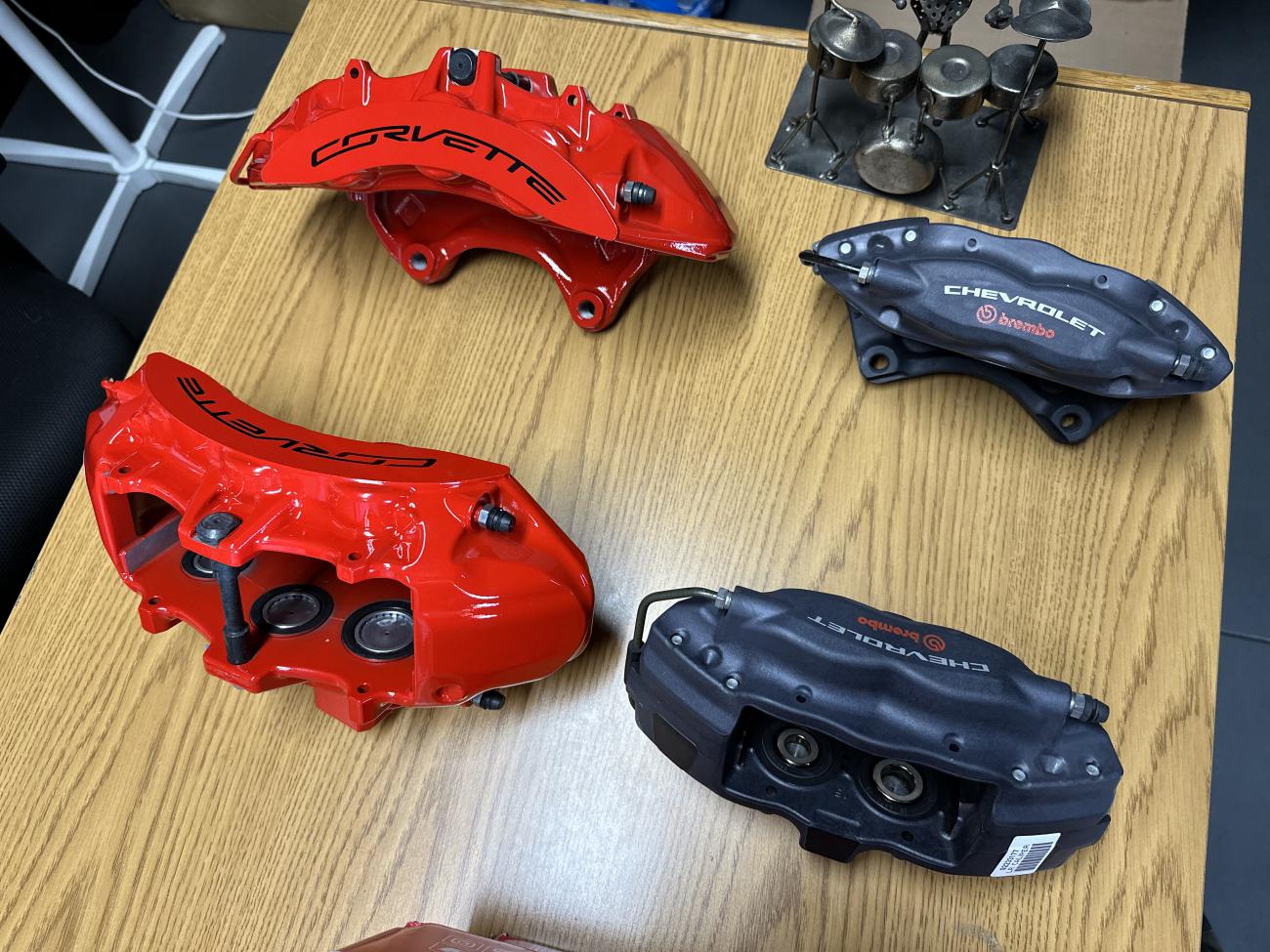

New Z06 and SS calipers. Paint question.
Well, I just bought a set of C7 Z06 front calipers and a new set of SS rear calipers for mu car. I plan to sand off the Corvette part, repaint, and add a new decal. Maybe Chevrolet or Brembo or both? Anyone know where to find larger high temp decals for these?
My main question is for the rear SS calipers. I’m going to paint them red and put on the decals I have. The way they come seems to be more of a dark gray primer. Can I just paint over these since they are brand new or should I sand them down? It honestly doesn’t feel like paint at all.

The current high temp stickers I have are for the SS front calipers. I’m thinking they are too small for these larger calipers. Thoughts?

I just finished painting the rear calipers. I have the front ones painted, but I haven’t received the new decals yet. Once those arrive, I will apply them and then put on the clear coat.

I used VHT caliper paint. I did primer them with the VHT flameproof gray primer first.
It’s all about the prep. Taped off everything that shouldn’t be painted. Then sprayed away!
