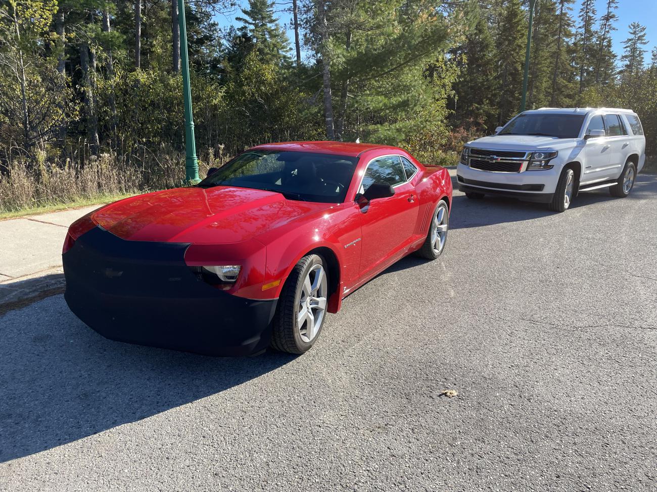

Tomorrow, I should be picking up a 10 2SS with 7,400 miles on it. Car checks out (buddy at GM ran a report), also clean Carfax.
This will be my 6th 5th gen. I'm very familiar with the LS3, but never owned a L99. Anything specific I should look for?
Obvious leaks, body repair/repaint are a given. However, 13 yr old car, 7400 miles, I'm a bit worried about seals and leaks. Any L99-specific weak spots I should pay special attention to? Completely unmodified and unmolested car (so the owner claims). I'll have to obviously confirm with my own eyes

Thank you everyone. Picked it up today. It’s been a 15hour day, round trip, but well worth it. 100% stock car, 7471 miles, at a price I couldn’t pass up.
