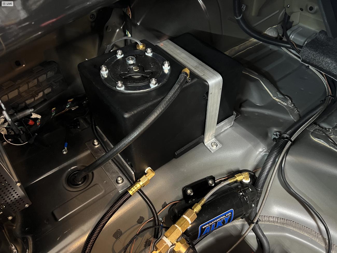

This is how I did mine - Just used some aluminum stock and used rivnuts for the bolts to hold it in place. Our tanks are different but something similar would work for you.

Looks like a couple of angle brackets front and back and a strap. Is that correct? And thank you for the pic. Did you put any of the carpet and trim back in?

That is correct. On the front angle I cut it so I could bend the ends to wrap around the tank for side to side support. I did not put the carpet or trim back in.
