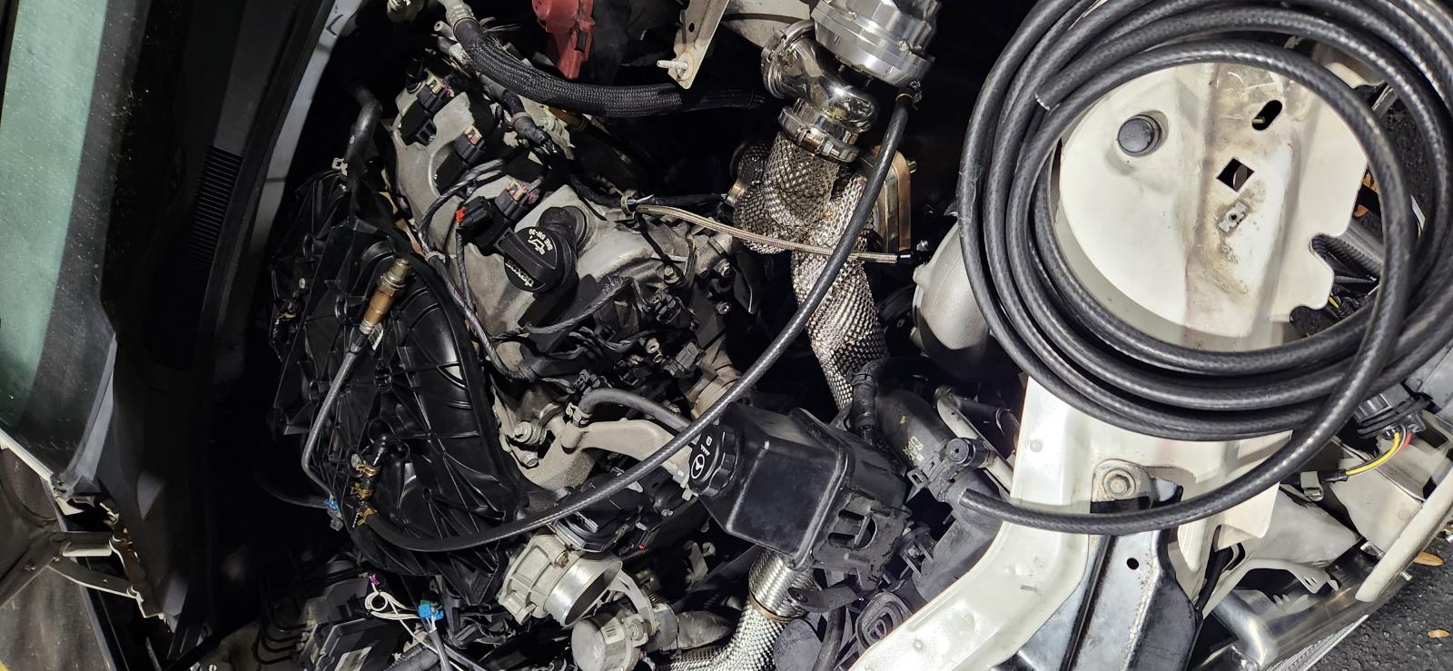

Update: I didn't realized but you should put the exhuast on the turbo first when first installing a turbo kit, so the headers that I made would most likely have to go to the garbage but that means the worries of the exhuast not fitting will go away. First thing I've discovered since learning about this is that the A/C lines have to go sadly, on the V8 the AC unit is where the alternator would be on the V6 so the AC lines are done another way. All I would need is a special tool to remove all the moisture from the lines to safely remove that, more on that later. I am now trying to do the oil drain while I wait for my next paycheck lol. There's not alot of space there to drill a hole and I was considering removing the oil pan until I found out you need to actually lift the engine a inch or two to remove it because the crossmember blocks it. So I will be using a punch tool and a hammer to get it done, the location of where I am doing it is on the passenger side. I'm ordering a 90 degree fitting for the drain before I do that.
