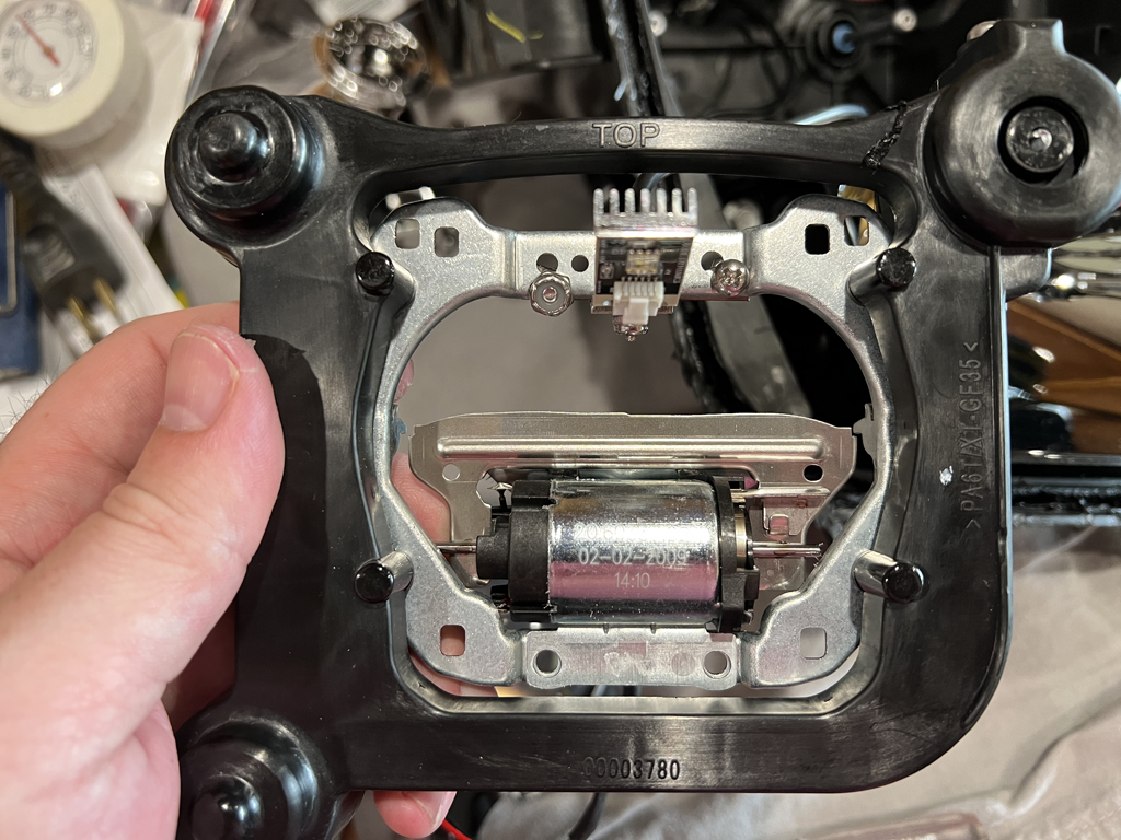

I took a bunch of pictures during the install, and I have been meaning to do a full write up. But just to give you an idea of what I did (so you can see how it compares to the Oracle version).
Here is a picture showing the original bracket for the Demon Eye.
Name:  2021-04-11 19.40.38.jpg

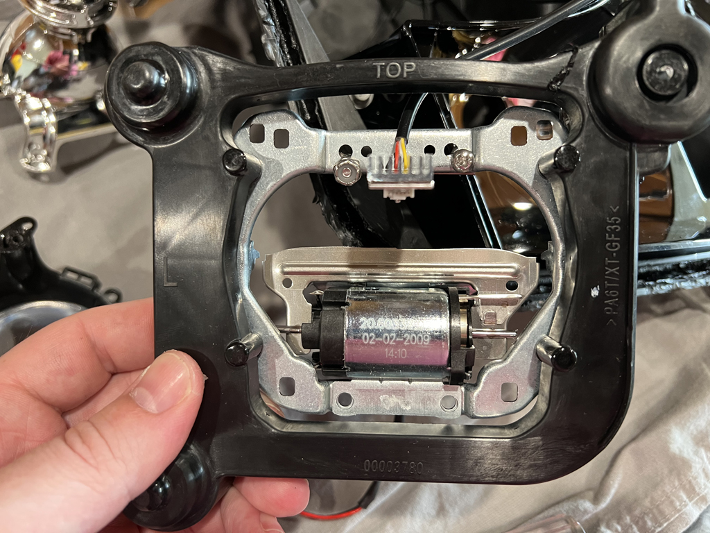

This picture is after I drilled the holes...I just picked a spot where there was enough "meat" on the bracket since nothing was going to line up. Since the bracket was too long, I marked where I would have to trim it.
Name:  2021-04-12 20.28.22.jpg

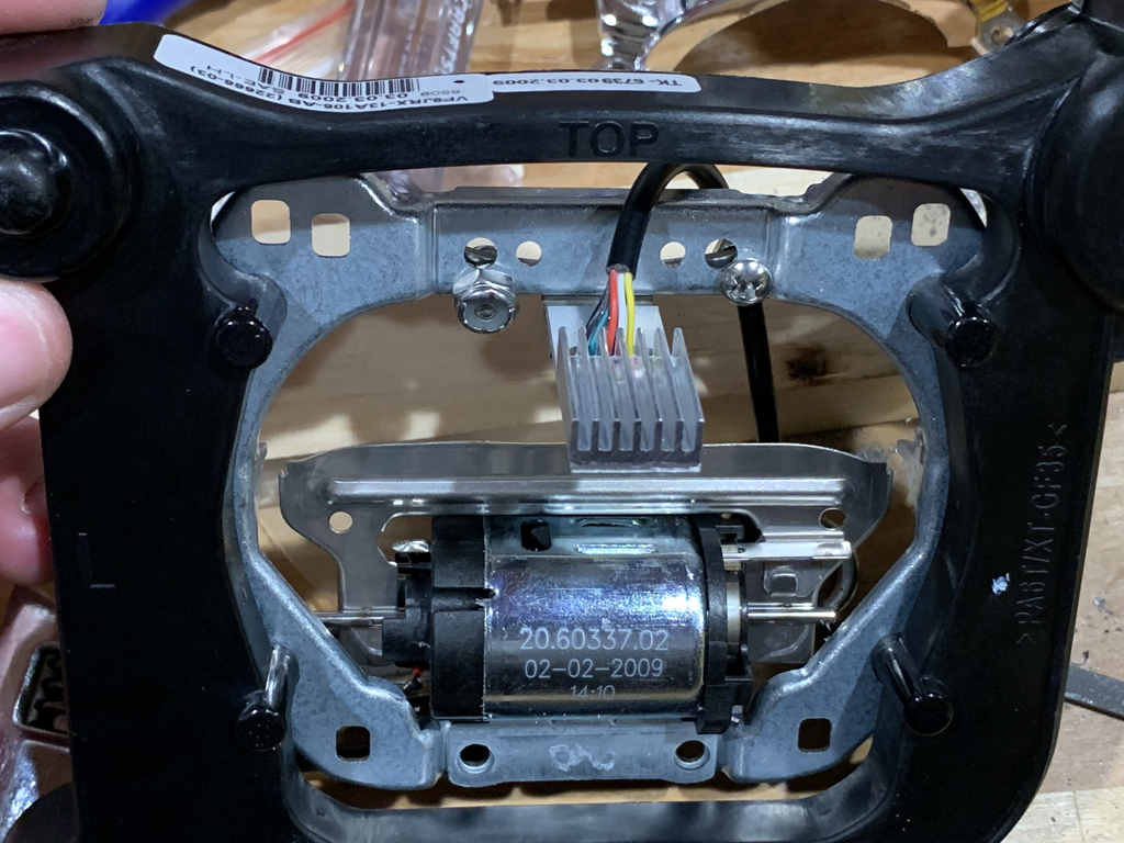

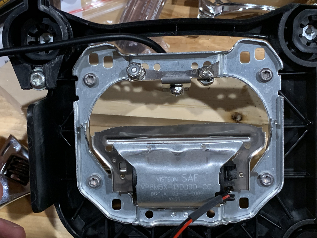

Using the bracket as a guide, I then drilled through the housing. I did one hole and mounted it with the screw so the bracket wouldn't move on me while drill the second hole.
Name:  2021-04-12 21.09.29.jpg
Name:  2021-04-12 21.09.46.jpg

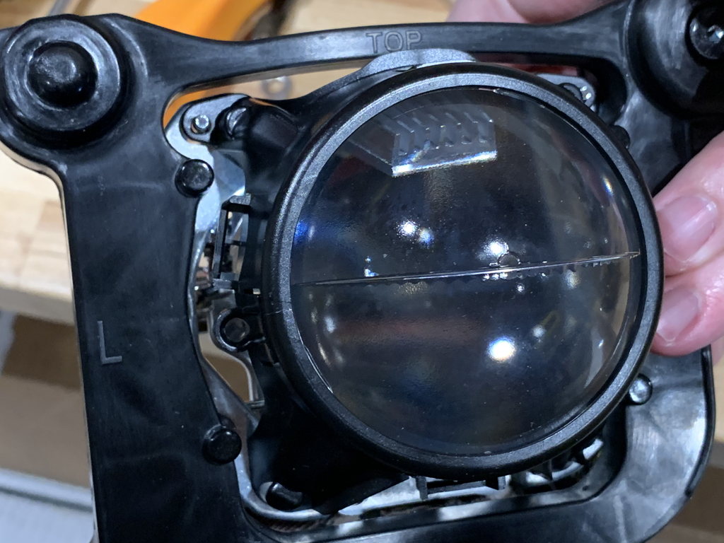

This is the part I messed up on, when I put the housing back together, it looked like this (not good)
Name:  2021-04-12 21.14.18.jpg
If I would have noticed that BEFORE resealing the headlights, I could have taken the extra two seconds to angle the projector up to hide the heat sinks.
