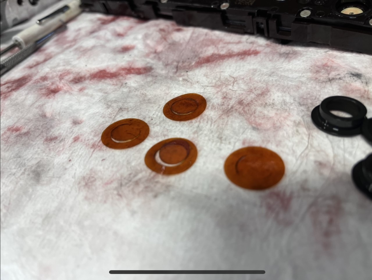

Read through this. It's possible you may be having an issue with your pressure switches. If one or more go bad you would most likely get a code stating the switch malfunction, but if the laminates/diaphrams crack or break like mine did, it will cause some shift flares and other shifting issues. Here is what mine looked like. 3 of them were cracked or broken.
Name:  TEHCM LAMINATES.jpg
https://www.sonnax.com/tech_resource...m-applications
Attachment 1126940
I will check that out thank you!
UPDATE: we got a chance to look at it this weekend and found that the transmission was actually 2-1/2 quarts low. There was a repair done on one of the trans fluid lines that had a slow leak. Fixed the leak and topped off with fluid. All issues are gone now except the weird shift at around 55mph. I let my mechanic buddy drive it and he said it is dropping to neutral for a split second when it tries to shift. But it does shift, just has a little neutral drop still. I’ll check the pressure switch thing out, we were thinking that might be what it was. Also I think once I get that fixed if that’s the issue I need to get it re tuned. He has tweaked my original tune to try and change the shift points etc to work around the original neutral shift drop at 41mph.
When we did the replacement of my laminates, and the output/input speed sensors which was what my issues was, my tech said a "retune" was not needed. He was right as the trans operates just like it did before the work, only BETTER!! lol. Here is a vid of the TEHCM pressure switches rebuild, got all my parts needed from SONNAX.
