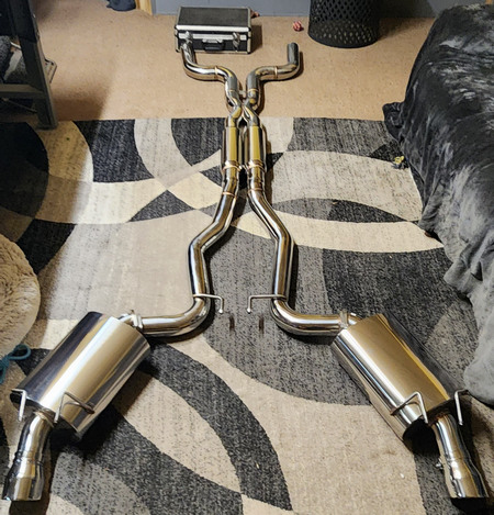

What does it sound like now? I went back and looked at the pics of your "new" exhaust, and it looks like just after the "x pipe" area you have 2 long resonators, and at the rear your mufflers. You could try 2 different things, the easiest would be removing those 2 resonators that should free up some sound, or leave the resonators, and delete the mufflers. Either way would net you more sound..

Word Bro I'd like to keep the Pots under there if I can but I will try to do the Resonator Delete, I just need 2 couplings and it ready to go, or I get some Muffler shop to weld it back on.

Yeah. Back when I had the Flowmaster Outlaw ZL1 catback on there and tried to quiet it down some and try to get rid of the drone, I installed some resonators about the same size as what looks like on yours, and it knocked the sound down way too much, so I ended up taking them back out because I missed the sound volume! Plus they did n't get rid of the drone the Flowmaster is famous for. That's why they call them "dronemasters"!! lol. Now I have the Corsa and love it!!

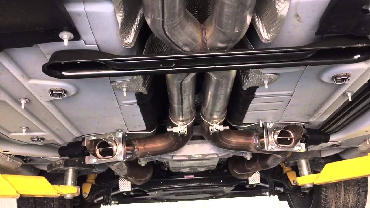

Well for me, I think it is still much quieter than the first vid for sure. You can leave it and do like SlowLS1 said and do the QTP's or the NOWEED's diverters. I have the QTP's and at a flick of a switch, open headers when you want. Not my Camaro, but the exact same thing and location.

What is that big ass bracket underneath there? Center Brace?
Yep. Trans tunnel brace, stock. Like I said, it's not my Camaro. Mine has the BMR tunnel brace on it.
