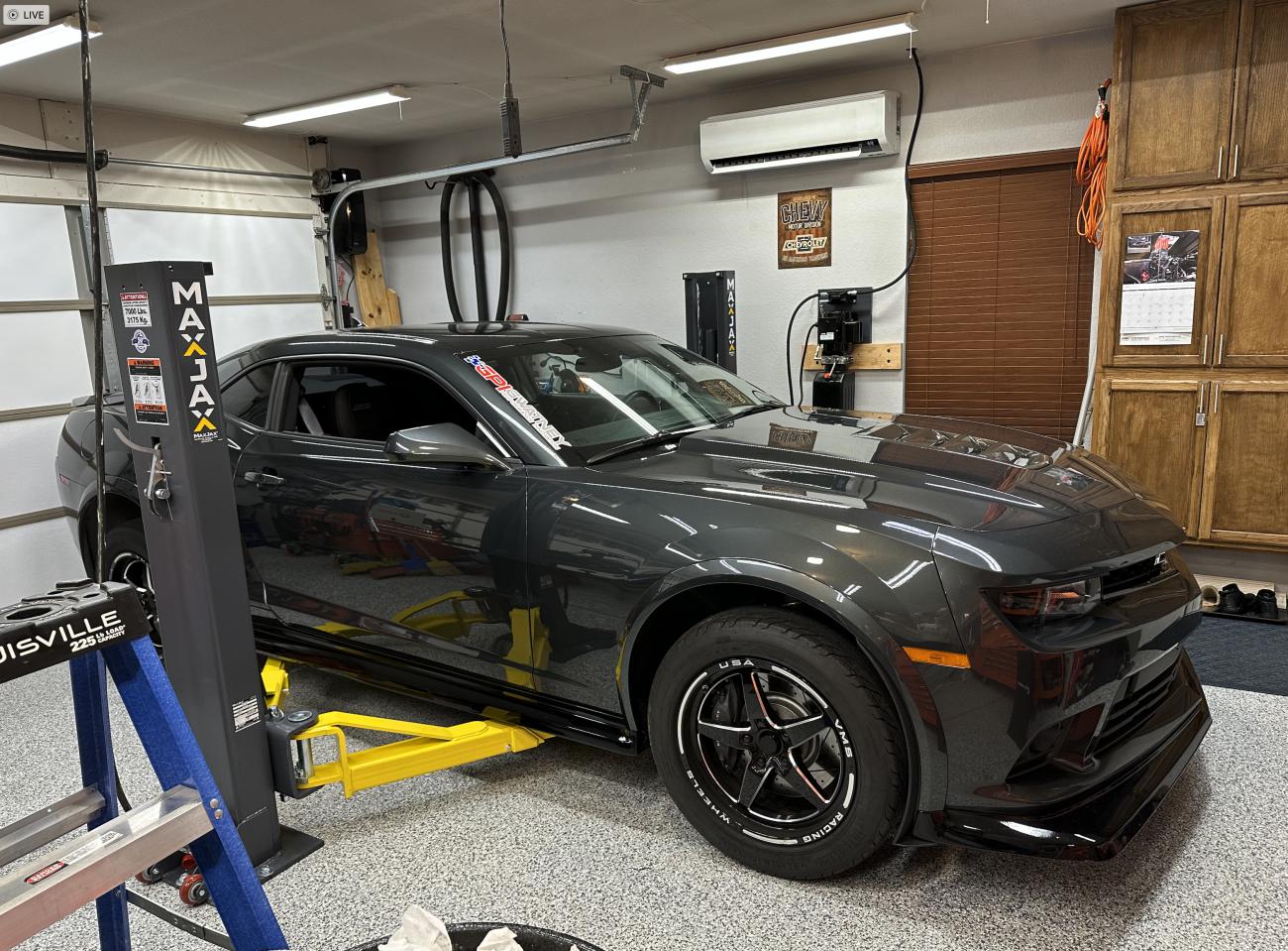

I have a 24k btu Samsung Windfree 2.0 in my 34x21 garage and it was installed by a HVAC company earlier this year. Love it! Wish I had done it sooner. I had a 220v electric heater out there for about 8 or so years now and it worked well for winter. But having this is just awesome and being able to go out there when it's 100 degrees outside and be comfortable is just amazing.
This was the only wall space I had that didnt have cabinets or faced the front door of the house.

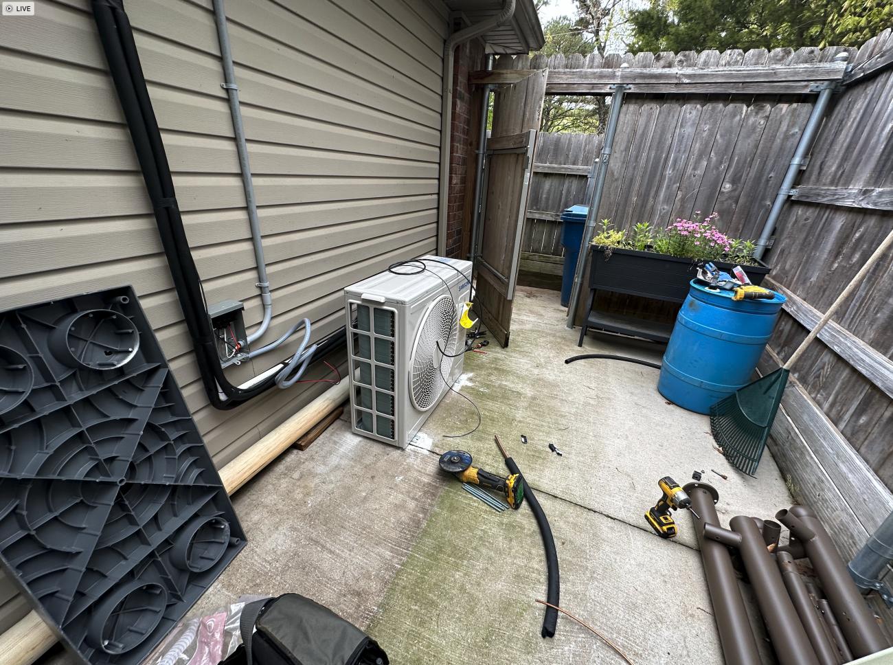

Outside unit when it was being installed -

The old electric heater wasn't very efficient at all. The installers said that the mini split would cost less for the entire year than the heater did using it in the winter.

Nice and clean looking install. My location for installing would be about the same. How is the heating compared to the old 220v heater?
Were the HVAC installation prices reasonable?

Posts: 2,173
It heats much, much better. Yes, I thought the price was very reasonable, the unit & installation was about double the Mr. Cool 24K 20 seer unit prices I see online. I called a few HVAC companies and they wouldn't touch a mr cool or self installed unit if I needed repairs or triaging.
