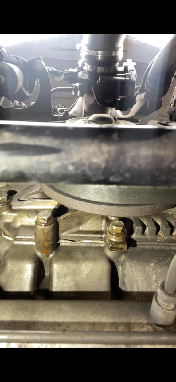

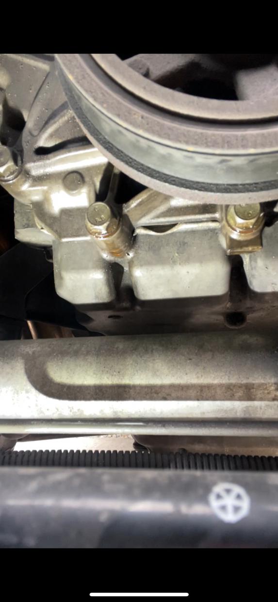

Went and reinstalled/cleaned all the injectors, fuel rails, IM, etc. waiting for delivery of all brand new OEM spark plugs. Also checked all of the fuses and they turned out good. Found that the LT headers actually fried the Crankshaft position sensor wires, so I cut those out, spliced, and tucked them away. That might have actually been the issue. Anyway, I jacked up the Camaro and found where the burning coolant smell came from. In the picture there is evidence of a leak under the crankshaft pulley.. just have to find out where it came from.

No crankshaft sensor, no rpm speed, no start. And I'm not sure if that returns a code.
Doesn't answer "accessories going off".
Coolant is "probably" out of the water pump weep hole.

What is the weep hole?

Sounds like a bad battery issue combined with damaged sensor wiring.
https://www.bing.com/search?q=waterp...5b&FORM=ANAB01
