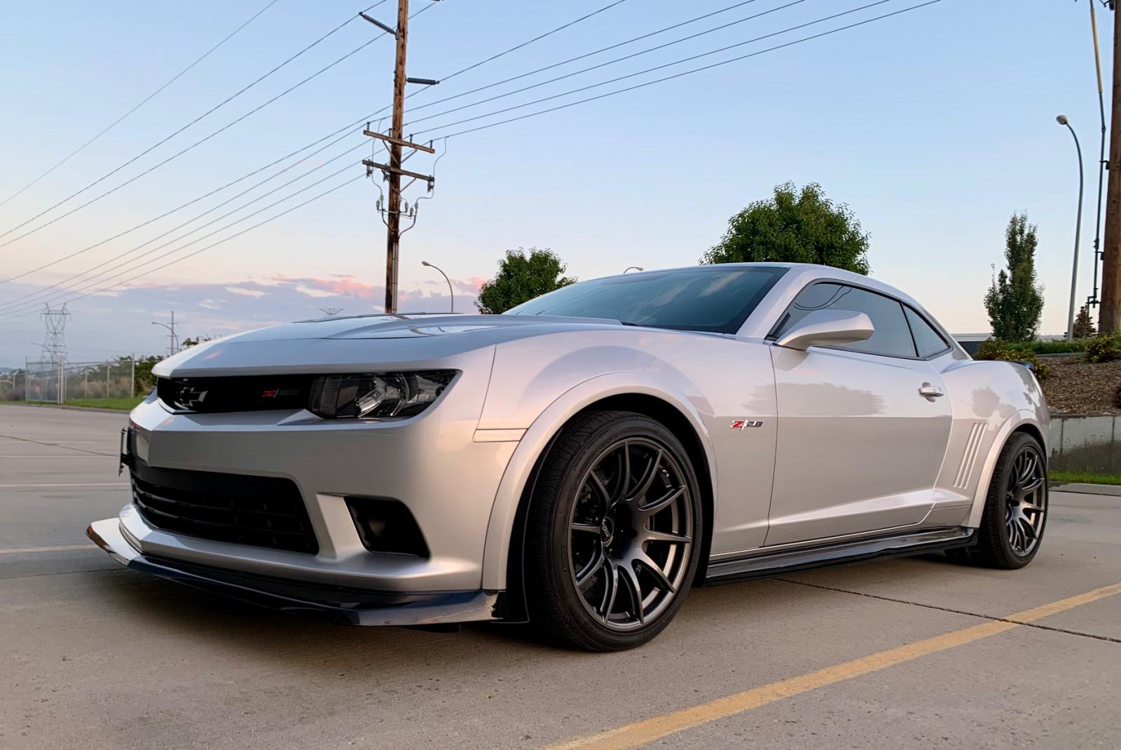

Not to thread jack, I went with Apex SM-10 in Anthracite 19x11 +11 all the way around. It gets that back tire out a bit .
Attachment 1153213
I contacted Apex a couple years ago and they recommended the 19x12 in the rear. Any reason you went with a square setup? Any spacers? I asked them if the 12 would fit without spacers and they wouldn't answer my question. Just told me the wheels would be wider or something general. I found it odd.
Your wheels look fantastic though!

Thank you! Stock tire size, Nitto Invo 305/30R19
Thank you, no spacers. I felt the wheel needed to be pushed out a bit to compliment the rear flare as the front wheel does and the offset of the 12" didn't get me where I wanted it.
