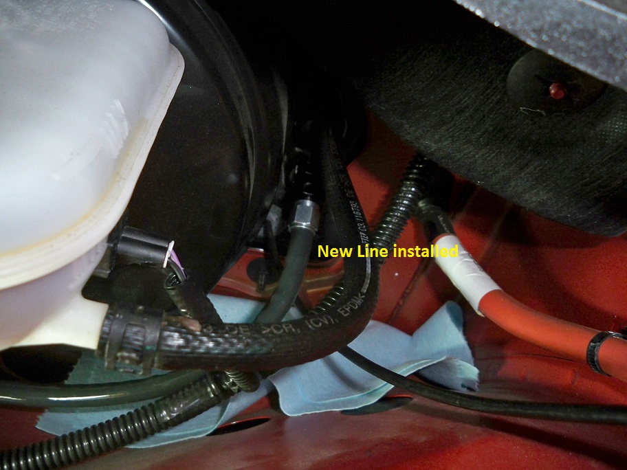

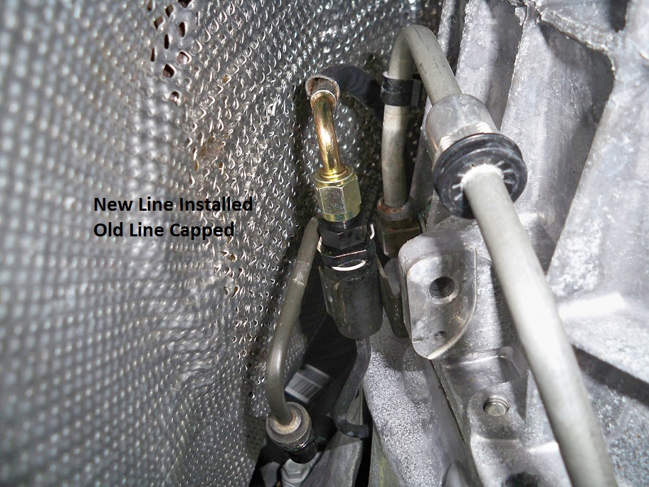

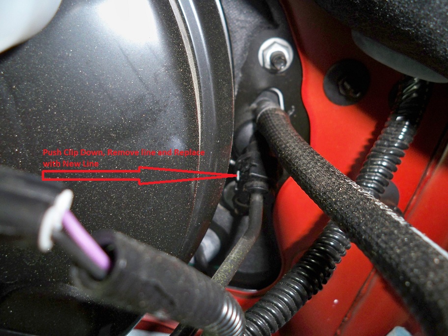

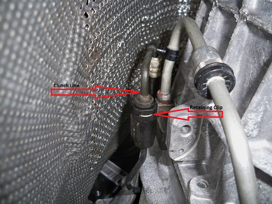

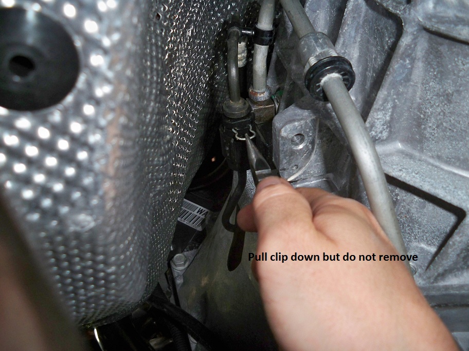

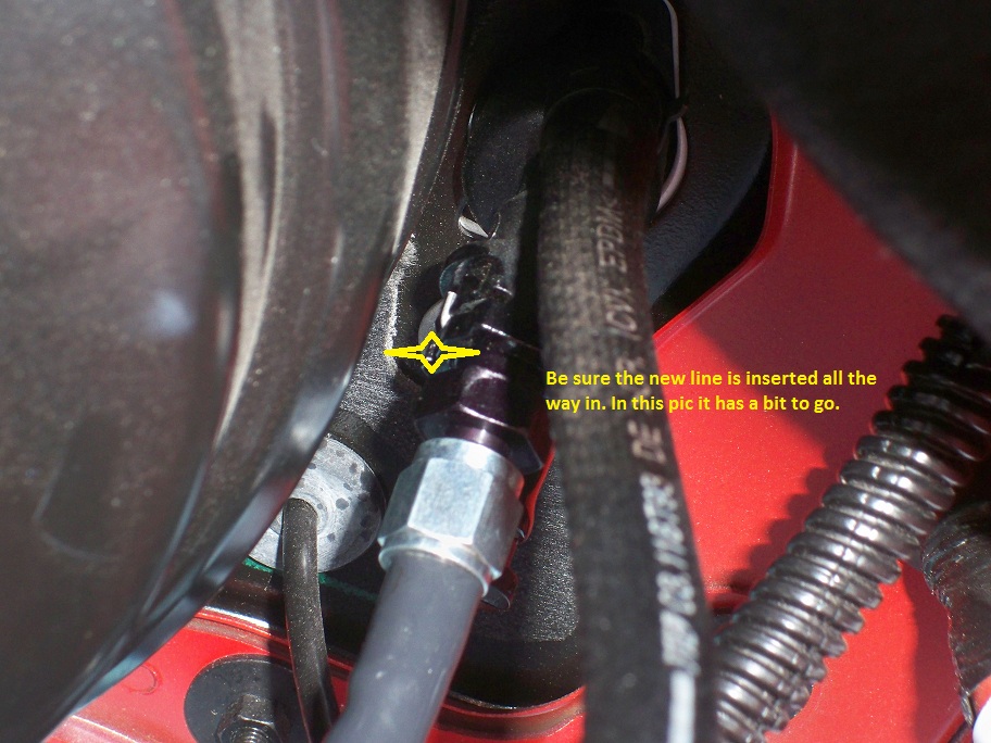

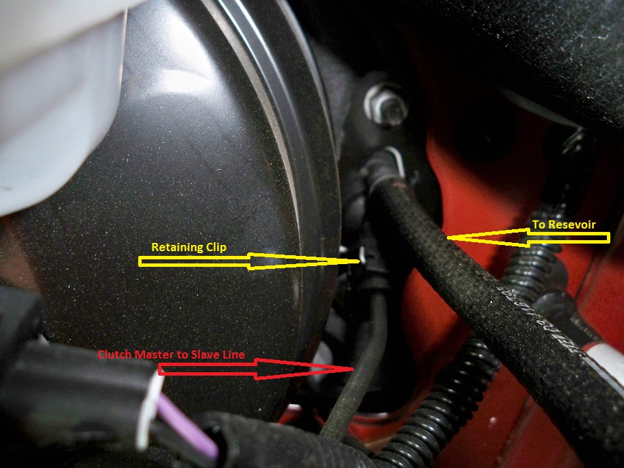

And since I already had these saved on my computer, I thought I would share some pictures that others posted on the forum. These were specifically for replacing the factory clutch line.

Yeah, I saw this thread with these photos before. Haha I was just confused since the Tick Performance website shows the Tick adjustable clutch master cylinder having the 90-degree connector going to the MASTER cylinder, instead of the slave. But since the factory setup has a 90-degree angle at the slave, it would make sense to stick to that.
I was thinking that if someone made a stainless steel, braided clutch line with 90-degree female connectors on BOTH ends of the line, it would work as well, as the stock clutch line also has a 90-degree (or close) bend where the hard line goes to the master cylinder. Hopefully, the way that I install it won’t leave a kink.
What if I decide to go with a cheaper clutch line upgrade without the 90-degree connector? From what I know, I think 36” inches (3’ feet) was around the size that the aftermarket braided SS clutch lines were, which actually gave a bit of slack to play with. I’m not sure how long the stock clutch line is, since it’s hard to measure…
Also, did did you mean that the Tick remote bleeder line or clutch line, was the one that was -4 AN in size? The Tick website doesn’t list any of the specs on either of those lines, so it’s impossible to tell without trying out the parts or comparing them to something existing. But as far as I’m concerned though, does the difference in size mean that the actual DIAMETER of the line INCREASES? I guess the clutch adapter fittings are all one size, except for the AN connection and size of the line, so it would still limit the flow to the same amount as factory.
And one last thing; the plastic(?) bracket that’s against the firewall, right near the area the hard clutch line connects to the CMC, looks like an absolute bitch to tackle. Have you attempted this job yet? I have small(er) hands, so I might be able to reach upwards and somehow fight the bracket; but I for sure wouldn’t be able to get that from up above the engine bay.

That’s interesting how the Tick line uses the 90 at the firewall. That got me curious so I opened the rest of the RAM kit. It turns out, both sets of their braided hoses have straight connections (there isn’t any with a 90-degree fitting). Please keep in mind that the RAM adjust goes in-line between the slave and master as it replaces the entire factory line. The shorter line, which goes from the master to the RAM adjuster is 12 inches and the longer line, which runs from the RAM adjuster to the slave is 36 inches. My guess would be the 90-degree at the firewall would allow the line to run under the brake master cylinder down to the clutch slave…which should allow you to use a 36” braided line. The RAM kit is designed to have extra length so you can mount the adjuster in a spot to get to the screw.
For the -4AN, that was for the Tick remote bleeder. The O.D. of that line was 1/4” whereas the RAM lines were 3/16”. The inner diameter will also vary between the different AN sizes…the smaller the diameter the more the pressure will be.
Unfortunately, I haven’t attempted this install yet. My plan is to install the RAM adjuster, a separator clutch reservoir, and the speed bleeder all at the same. I’m sure the fitting at the firewall will be a pain, but I’m not really looking forward to installing the speed bleeder. However, I figured since I’ll have to bleed the clutch anyway, I might as well throw the speed bleeder in to make it easier next time.
