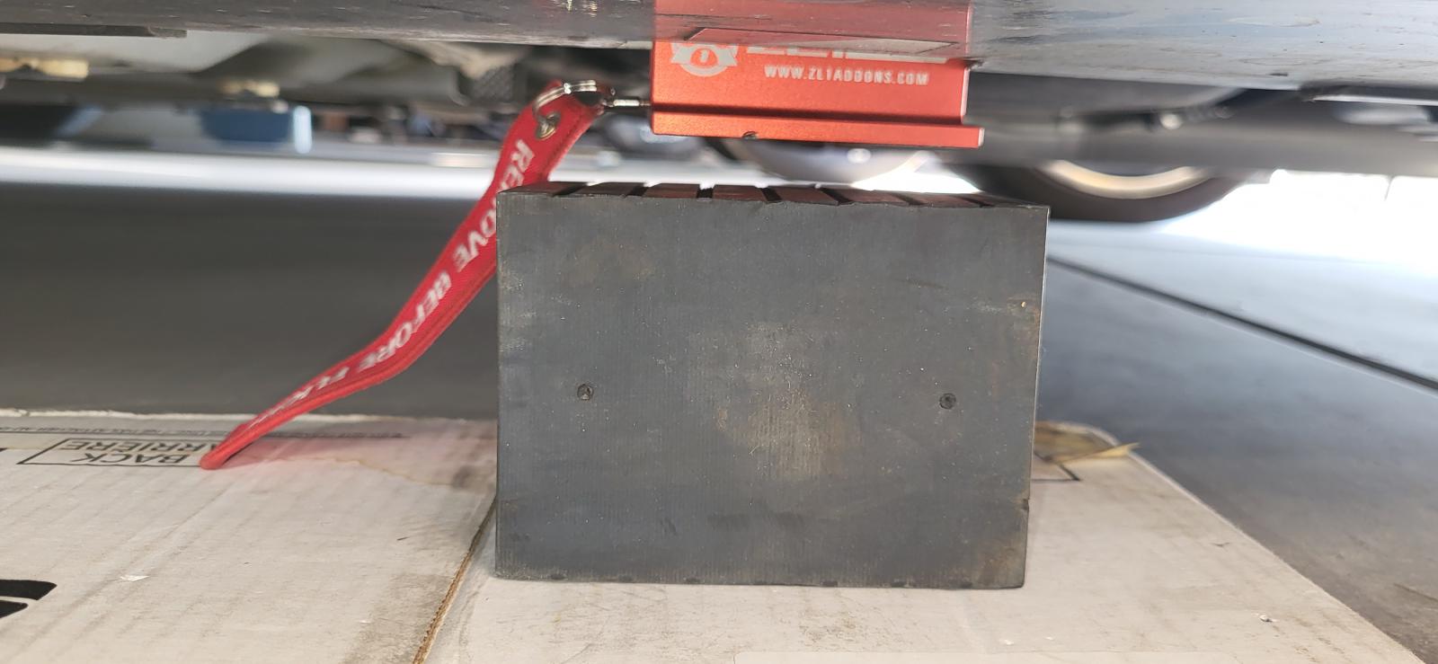

I've got the discontinued 5000 SLX model. Works great for my Camaros and my C5 Vette. I use the ZL1 Addons magnetic lift pads at the pinch weld points. Oil changes are MUCH easier!

Would it be possible to take a picture underneath the car? Specifically the lift points?
Thanks

Awe man, you're killin' me. LOL! Unfortunately my C5 track car is up on the QJ at the moment as I've got a track day coming up. Here's a pic of the QJ block in close proximity to the magnetic ZL1 Addons pad on the pinch weld point on my Z. Trust me, if you can change your oil you'll have no problem with the Quick Jack.
Thank you very much! I am just afraid if I put it up on jacks I will crush something!
Thanks Again!
