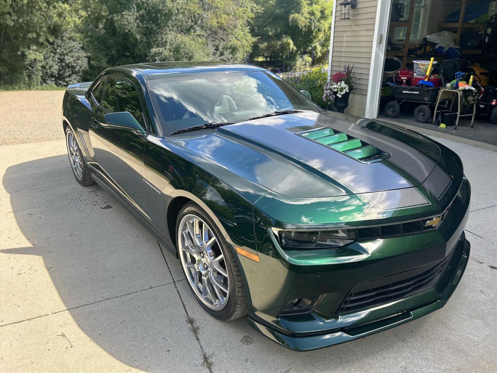

Newbie to the Camaro scene; got myself a 2015 2SS Green Flash, but the lower bumper lip has a chunk missing from it.
I got a replacement piece for a generic 1LE replacement, but it looks like there are some rivets holding it in place.
What are the best methods to remove the existing broken lip and what should I use to replace the rivets I remove? Go with OEM style rivets, or use something like a barrel nut and bolt?
