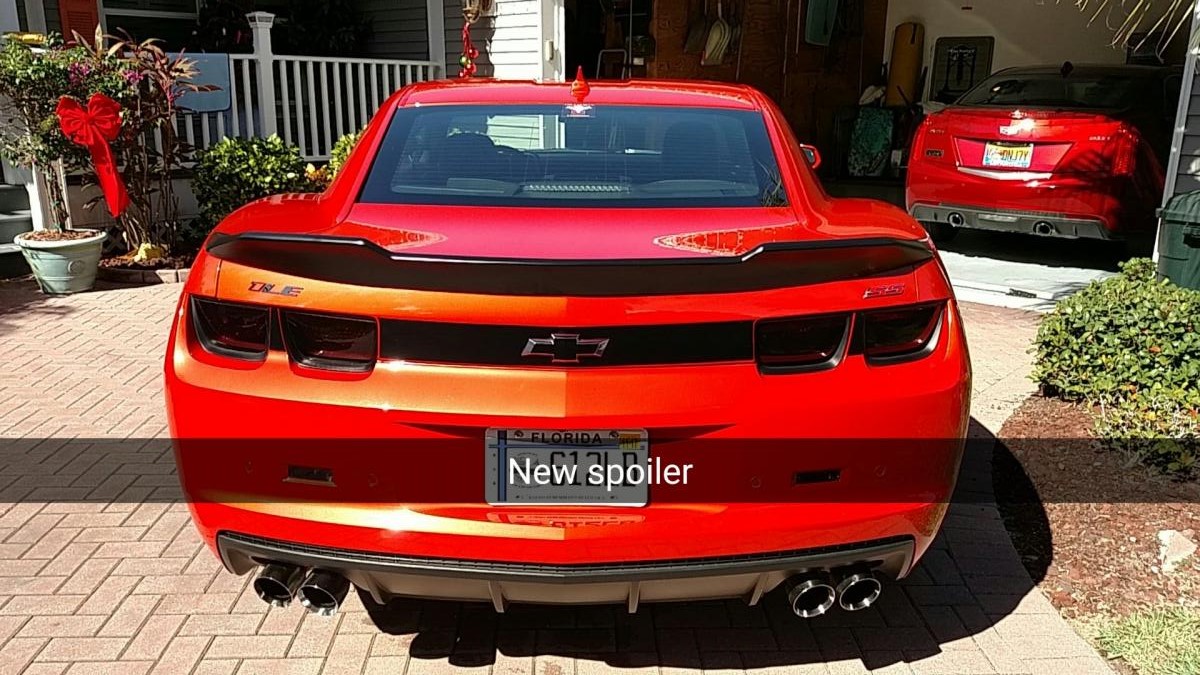

Got your Camaro off its door!! lol.
Attachment 1169252
thanks
