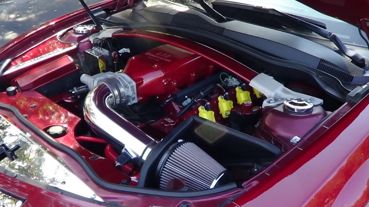

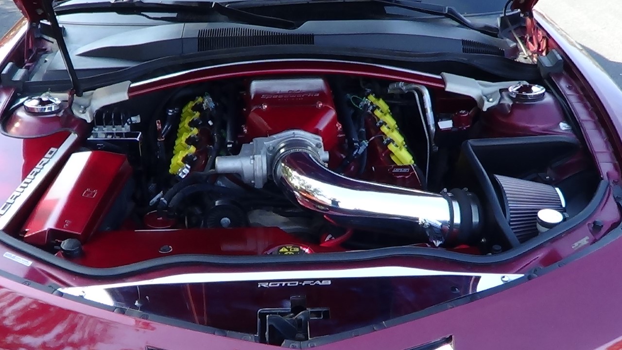

Agreed with all of this. I have a similar intake as I have the LOD on mine, they aren't being made anymore that I know of. When we bolted mine on we gained about 37-40 more RWHP. The thing about these manifolds is they lack some bottom end, but as mentioned picks up around 6800 and beyond. When we dyno'd mine we pulled it out to 7500 and it still wanted to make more, but called it a day because I wasn't sure which GM performance lifters I had in the engine. A lot of theguys are using the OEM rod mod manifolds and getting good gains with it, even boosted. I love the look of mine, and it gets a lot of attention, but I never run it past 7200rpm. And since it loses some bottom end grunt, I run a 4500 stall to overcome that.
