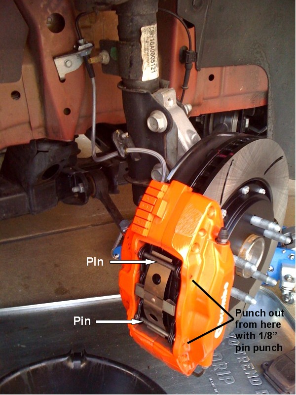

Here's a pic of the two pins that you punch out, then the pads slip out the back.

I feel stupid now... But great pic !
Makes me wonder... no clips, threads, or cutter pins? Only friction/compression on the pins? Oh well...
This is simpler than I thought. 1-1.5 hours, tops.
BTW, nice painted caliper and are those 2-piece rotors?
Thanks.

They are RacingBrake.com two piece Open Slotted rotors.
Here's the link:
http://www.racingbrake.com/CAMARO_SS...138-381-01.htm
