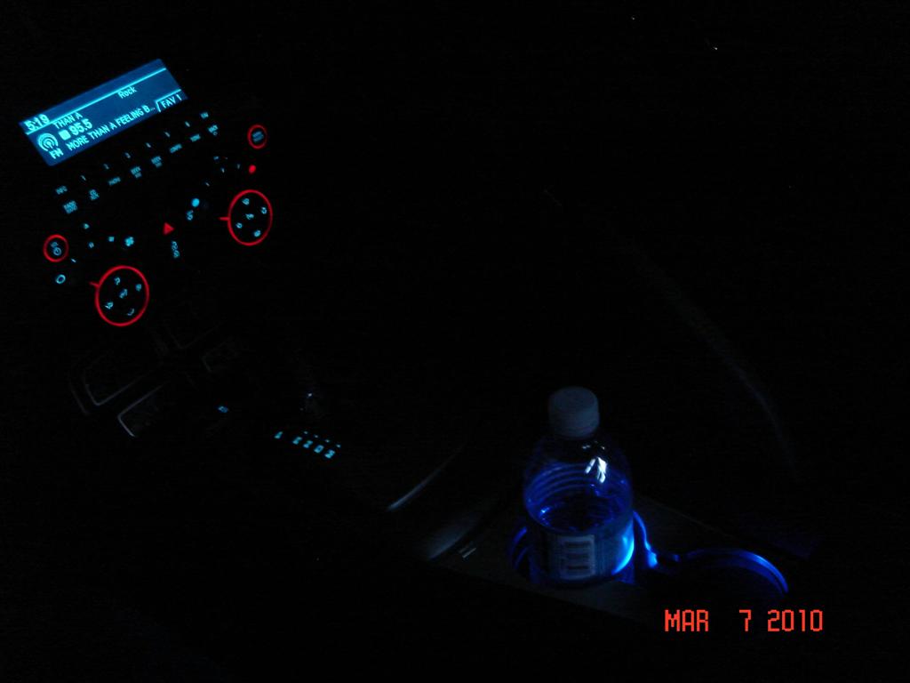

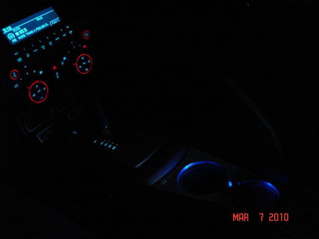

Well here's an install thanks to BMWDON's idea of LED lighting the cup holders. I bought the same billet cover (on eBay for about $65 delivered from Hitechcustom). I got the blue stick-on LEDs at Pep Boys for $13.

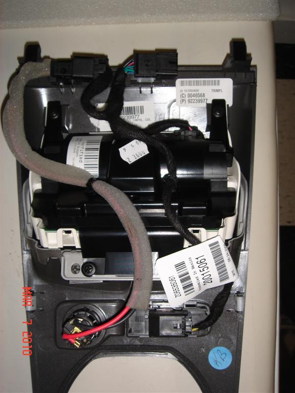

I thought I was on to connecting the LED power to the 4 pack gauge lights until I took apart the gauges and discovered they are all electronically controlled. Damn LANs .
So I just t-tapped power off the power outlet red and black wires. I mounted the LEDs to the console and the billet cover covers everything. Nice simple mod and effect. Thanks BMWDON.

Quite simple. The third picture shows it all. The LEDS I got at Pep Boys, I have one pointing about 45 degrees into the front opening and the other about 45 degrees into the rear opening. You have to drill a small hole (1/8") to get the wires under the console. I connected the wires to the power outlet red and black wires in the front of the consoles using T-taps. I used the 3M emblem tape to hold the billet piece down. You can get the 3M tape on eBay too.
The credit for this goes to BMWDON for the cool idea.
