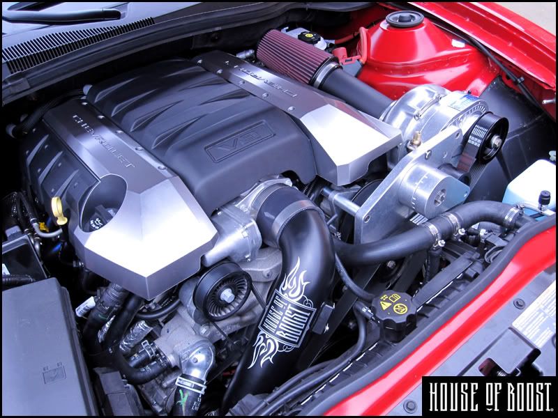

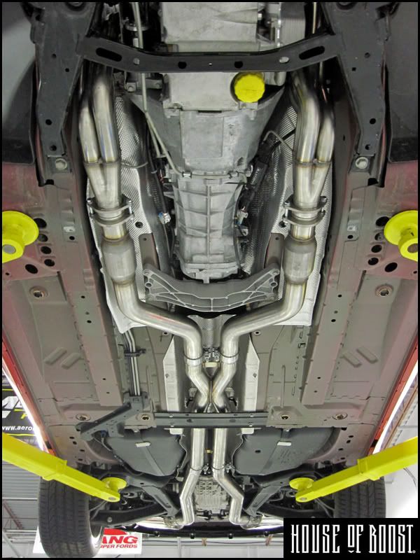

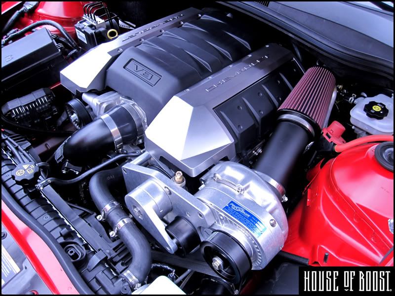

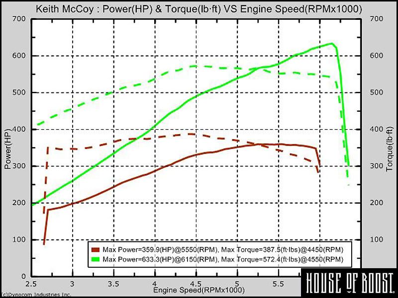

New to the forum! We just finished up a 2010 SS that we installed a ProCharger P-1SC-1, our Stage 1 forced induction cam, and full Kooks exhaust. We've done a few 2010's with blowers with good results but this is our first Stage 2 SS that includes a cam package. Even with a baby blower cam, we ended up with 633rwhp and 572rwtq. Not bad for only 7lbs of boost. We have a lot of fun working on this new platform and look forward to getting more power out of them.

Very nice. Looks like you're at the end of what a BAP can handle. Time for a fuel pump upgrade.

Thanks. The owners goal was to push the factory fuel pump without pushing too far. AFR just crept up to 11.4 at the end of the pull so its plenty safe and he's happy where the power is at. If we did out Stage 2 cam I know we would be looking at a pump upgrade.

400lb-ft of torque at 3000RPMS! And out of a P-1...very nice!
