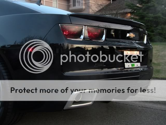

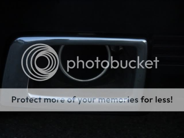

Here is a few pix of my GFX from the rear.. not sure if you can tell/see from this angle/distance.

Hmm looks like those are the special GFX ones. The stock ones are chrome, the GFX ones are more of a stainless steel.
It is possible that they are still rubbing on the bezels though. Get down and look really close at the tips. How much clearance is between them and the bezels? If there isn't much, see how much you can wiggle the pipes. At certain RPMs, the exhaust pipes vibrate a bit, and might be pinging off of your bezels.

ive got absolutely no issue with the GFX 13k miles- it almost looks like the tips were'nt cut back enough before they put the caps on- not sure if that could be causing the problem or not- it just seems fishy that the GFX are causing the noise--its a body panel not a mechanical assembly.

It almost looks like the tips are too large or too high for the opening and the tops of the opening is actually acting like the inside of a whistle.. when you blow a whistle it splits the airflow causing a vibration, I bet this is what is happening...
