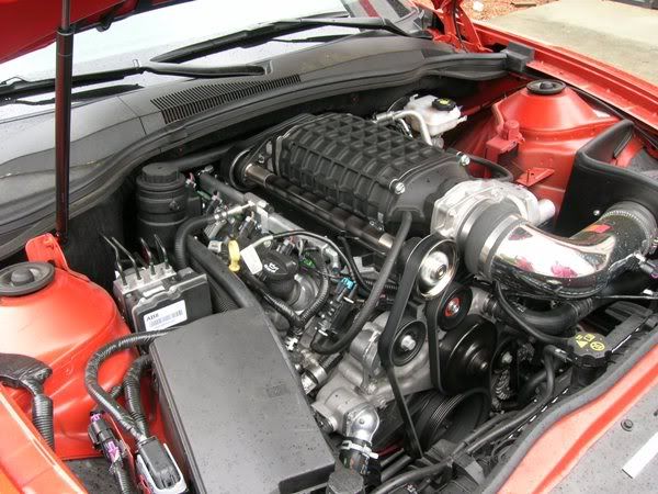

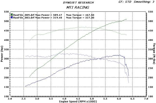

This Camaro still retains it's everyday driveability but has been transformed into a Hot Rod Camaro that see's track time as well. I figured the customer is happy with his Camaro the way he blew by us on I-75 headed to the CamaroFest, made us look like we were standing still. Check out the dyno sheet and pics below.
509rwhp
Taking a look at the TVS 2300 Supercharger
Maggie TVS 2300 Supercharger
