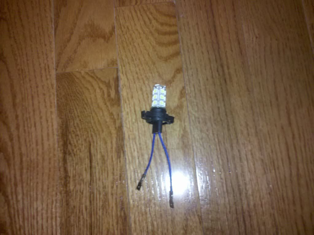

Are these what the 5202 led fog lights suppose to look like? I thought they are plug and play? Anybody....?

idk i just got my p-13 s

and what do yours look like? i know they are different....
