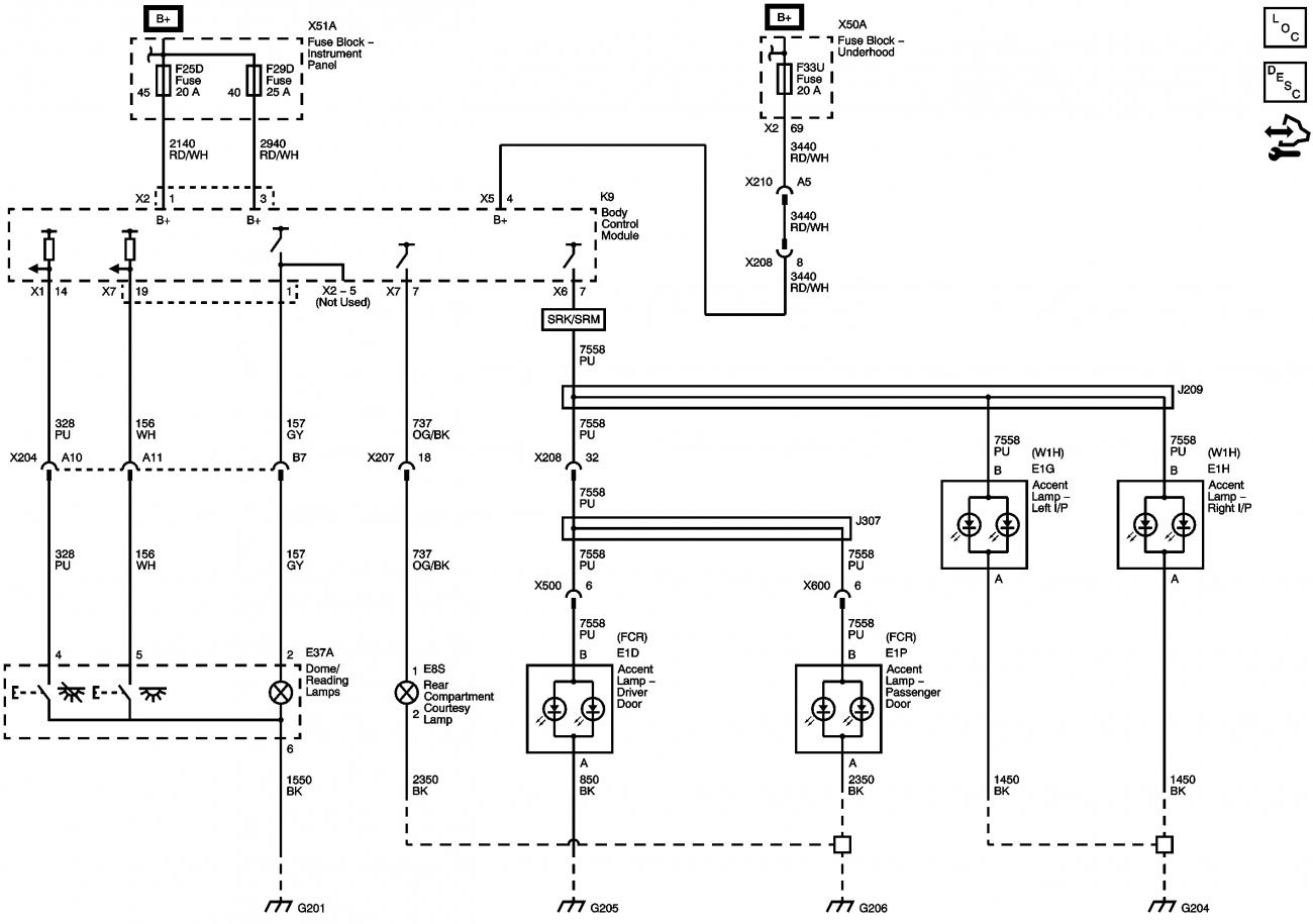

Here goes. The light is an LED light, with a 5mm diameter Acrylic tube, with a small white stripe along the back. When the light is shining down the tube, the white on the back reflects that light out of the panel.
The panel is painted from behind except on the curve. The rest is just clear plastic.
The ambient light circuit is dimmable. I've have yet to find actually where it originates from, but it is a purple wire, and the diagrams show an SRK/SRM or something. That appears to be where you need to find to get the real ambient light circuit.
http://www.camaro5.com/forums/attach...1&d=1259102106
You could go with the door LED for the window switch, use the yellow and black wires to hook up the lamp and it will still be dimmable. Only difference is that this circuit (IP) will not dim all the way off. It will stay on at the lowest level.
Hope that helps.

Does anyone have any updates on this? I tried the yellow and black window switch wires and that did not work. Actually fried out my driver side window actuator.
DMan918 is offline   Reply With Quote
Old 10-06-2020, 07:49 PM   #10
spyderbuddy
Drives: 2010 RS Inferno Orange Metallic
Location: Albany, Ga.
Posts: 3,474
Look for a Plug on the door panel above the door speaker in the wire loom.
You can just make it out in this picture.
All 2010's had the wiring for the ABL's in the harness, Even in the dash.

Fuse? and the headlights parking lights have to be on
spyderbuddy is offline   Reply With Quote
Old 10-06-2020, 08:39 PM   #13
spyderbuddy
Posts: 3,474
I installed the ABL dash Lighting kit from Gen 5 and just plugged them in the dash
the plugs were there also. Most car companies do not make separate wiring harnesses between Trim Levels, it would cost to much. But don't mean they may leave a fuse out if that system is not used.

Looking at the Electrical book for the interior Lighting page 12-47
Fuses F25, F29 & F6 Controls the power for this part of the lights.
