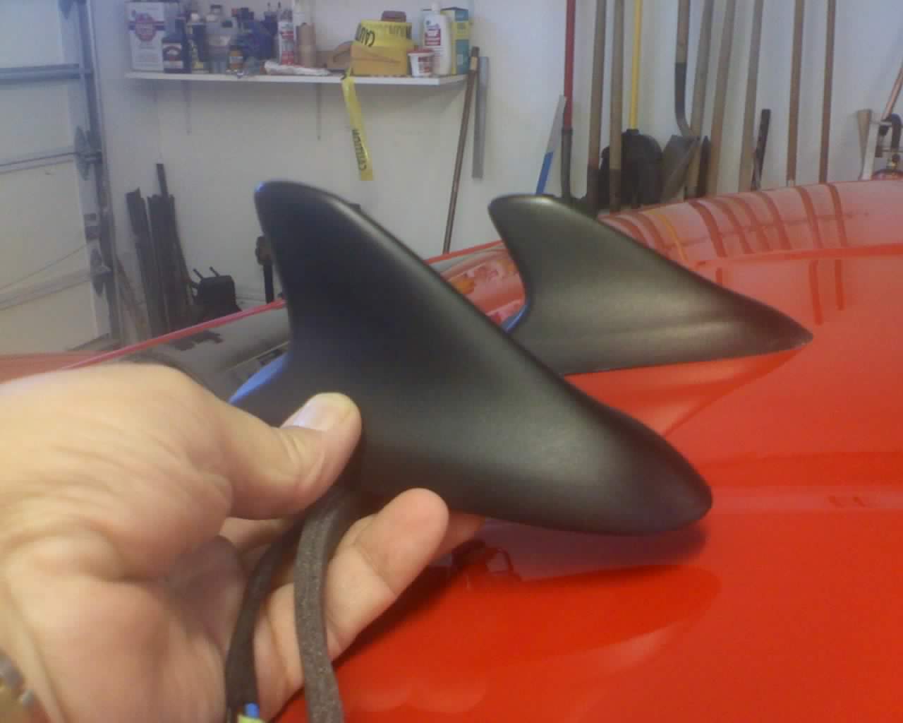

A lot of you know how to remove the antenna i will only post the link at this time,Thanks for making the videos GTAHVIT.
Part 1 http://www.camaro5.com/forums/showpo...0&postcount=51
Part 2 http://www.camaro5.com/forums/showpo...7&postcount=60

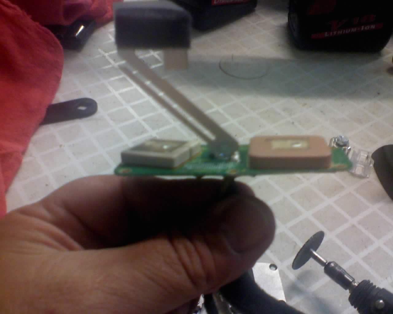

You will need to take the Antenna apart so let start You need to take the 4 blk bolts there real small use a T-8 and that takes the fin off the housing.

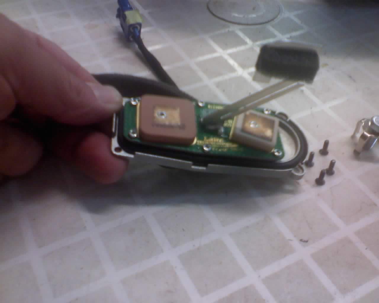

This is what is inside the fin.

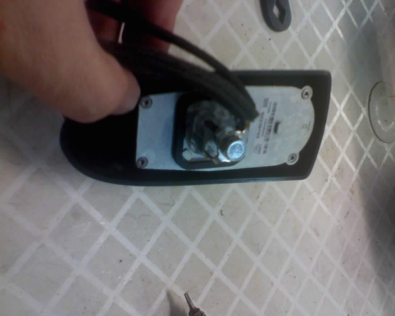

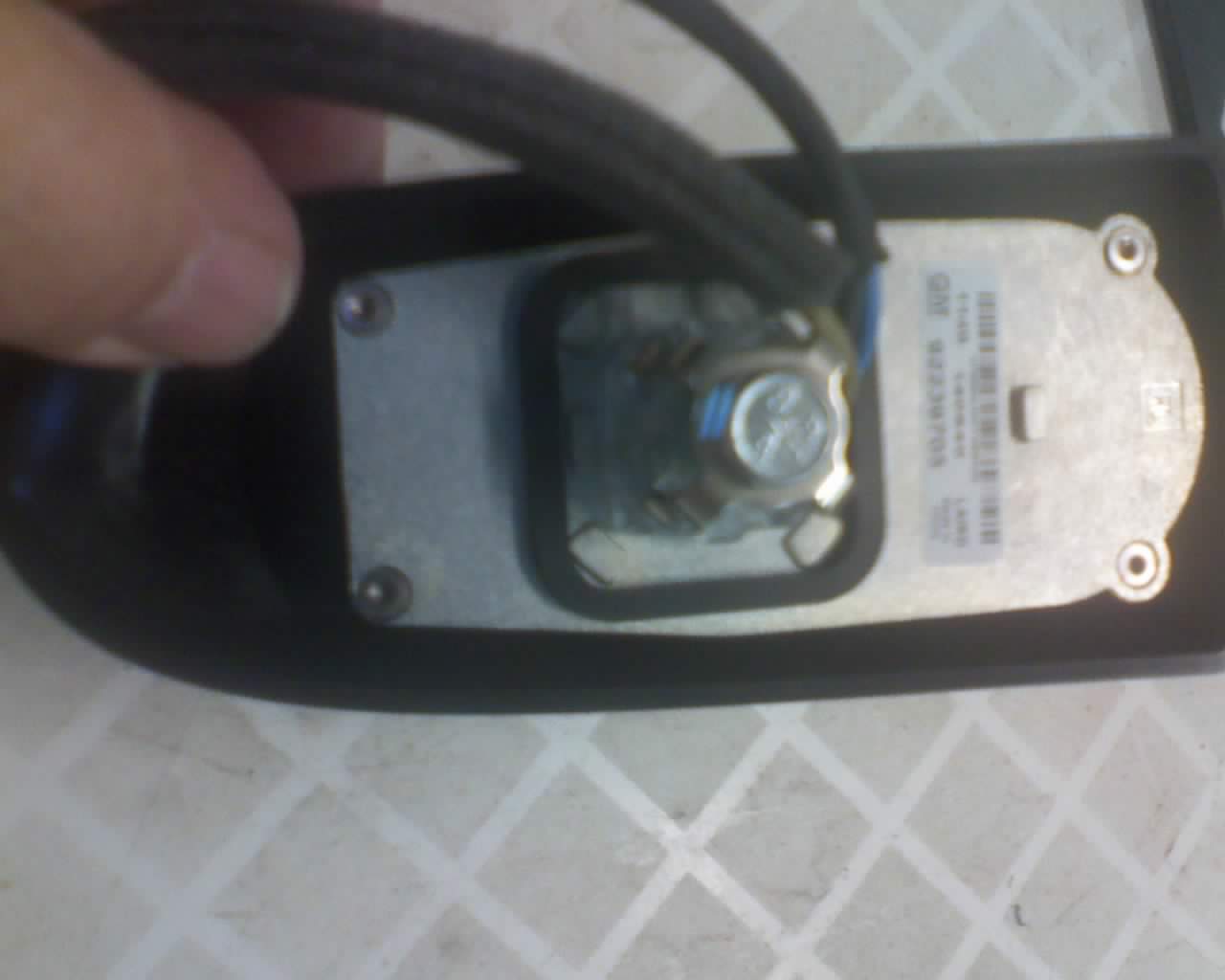

Next there are 6 silver bolts there real small use a T-8 and that takes the antenna of the metal bottom of the fin. same pic but you get it.

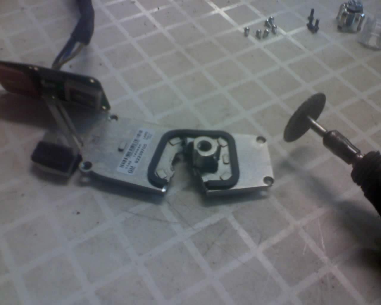

Here is one of the hard parts i used that old and handy dremel tool with a cut off blade to cut from one side to the mid way without cutting the wires then i put it in a vice and hit it with a hammer, Here is a pic
And this is all of the antenna.

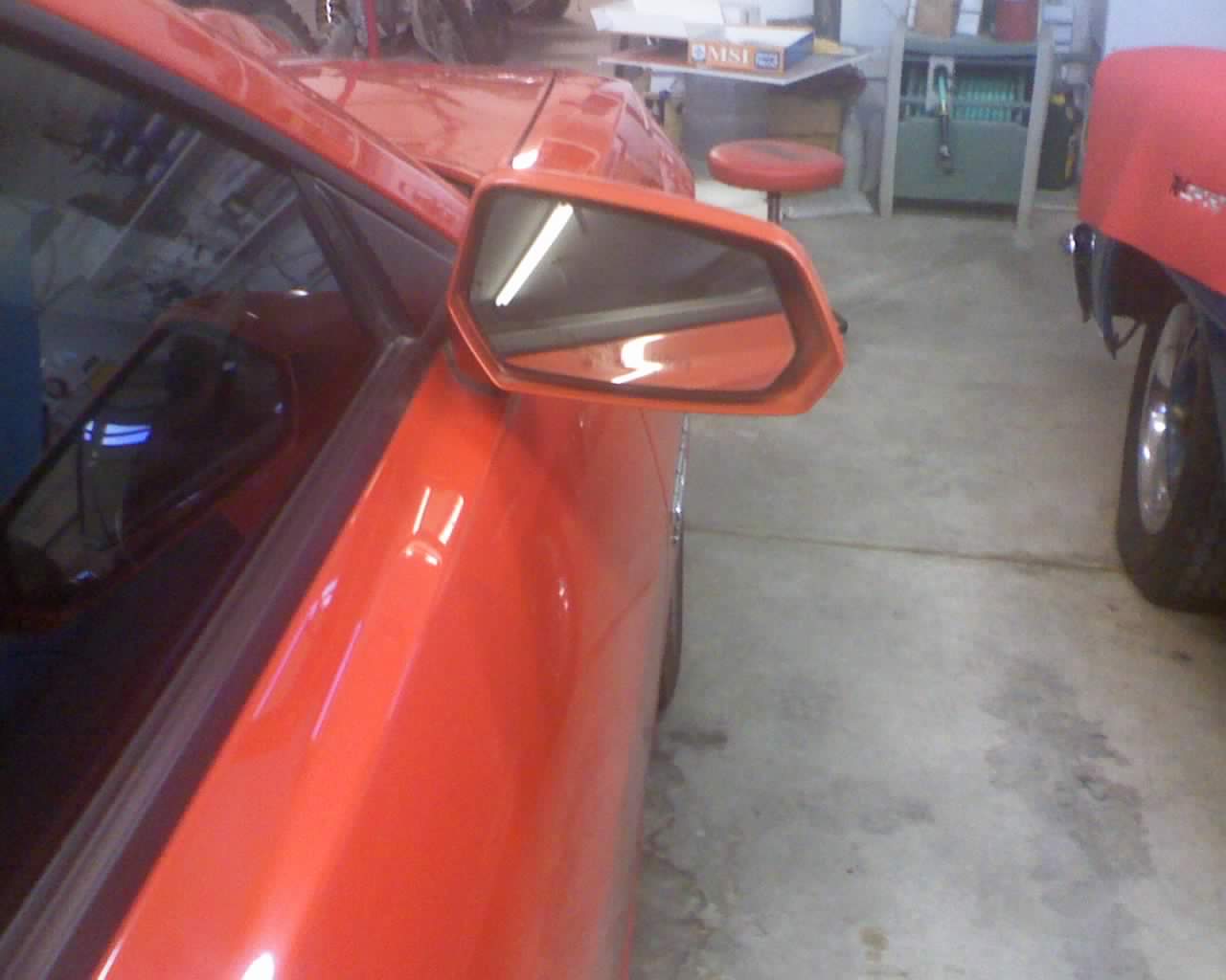

So that's all for today more to come in the next day or two there are more wires to add and then how to remove the door panel and remove the outside mirror and place the antenna in there.
This is where the antenna will end up.
