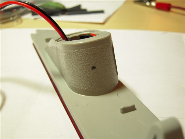

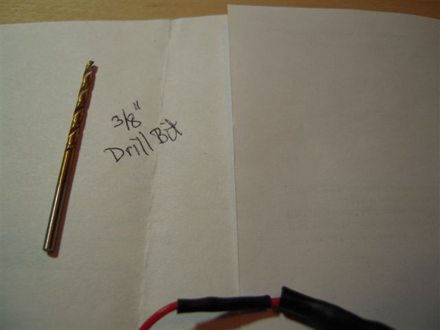

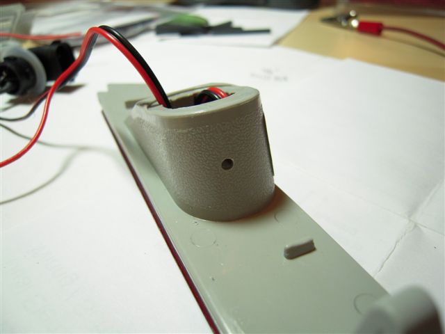

Here is the pic of the AAC LED side marker and dual intensity wiring harness.
The second pic is of the dual intensity wiring harness installed in the LED side marker. The shrink tubing is 1/8".
The third, fourth, and fifth pics are the spot on the marker assy that I will drill to put the turn signal wire through.
The sixth pic is of the fully assembled LED side maker with turn signal wire through the marker. After you have pulled the red wire through the hole put a some clear silicone to prevent water intrusion.
The seventh pic is of the LED side marker with just the running light on. View the video to see what it looks like as it would blink.
