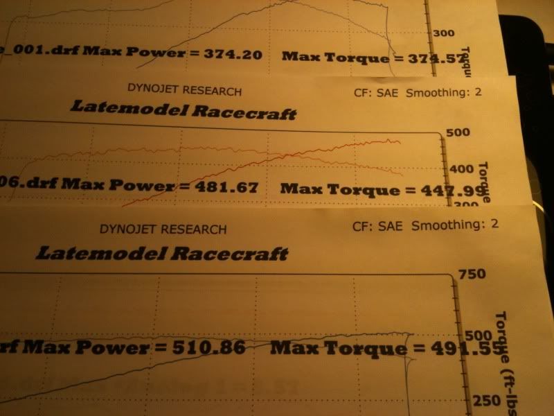

From top to bottom: Stock, 3.8, 3.6:
Keep in mind this is through stock exhaust.
There is Another 50 with Headers and an ADM CAI.
Ted.
www.jannettyracing.com
Celebrating 39 years Performance parts, Installation, Fabrication, Dyno tuning, Remote custom tuning, and alignments. 203-753-7223 Waterbury CT. 06705
email tedj@jannettyracing.com
Thanks. Are u running a ls3 engine? My stock was at 326rwhp and
dyno 3.8 at 500rwhp. Was hoping for 525-550rwhp after pulley change. I wanted to stay pump gas, but sounds like fm Ted that I hAve to upgrade to meth. Gotta check up on diff meth kits avail for the L99 engine.
You can drop to a 3.6 with an MSD FPVB and a Tune.
3.4 will require Coolingmist kit, and above.
Ted.
