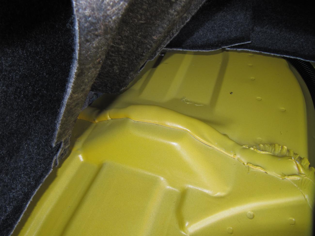

Not sure if anyone has posted the changes for 2012 suspension yet, this was the first 2012 our shop received with FE4. Thought I would share some pictures of the changes.

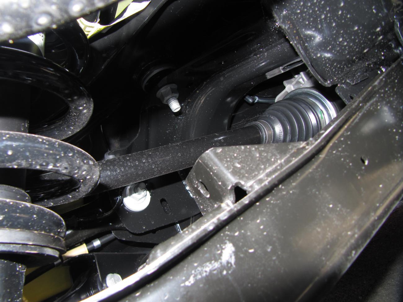

First visible change is that the rear swaybar is wider & continues around the rear coil spring, and is now connected with a conventional straight endlink.

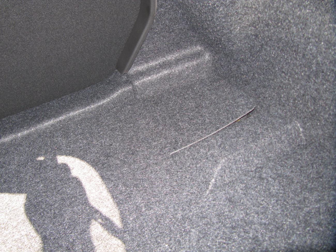

Inside the trunk there are 2 humps in the floorpan, most likely to accomodate changes to the rear suspension module.
Front swaybar endlinks have been upgraded to a larger diameter also.

I'd say yes, handling is improved, though I really didn't push it to extremes.
As far as interchange, it looks like the front endlinks could work in '10 & '11's.
The rear bar is a different story... the clamps that mount the bar to the cradle are in the same location, but the lower control arms on the '10 & '11's do not have provisions to mount the new endlinks, so you would need to replace the lower control arms, sway bar and endlinks.
Oddly enough, you could however mount a 10-11 bar onto the '12 because the old endlink mounts are present on this car.

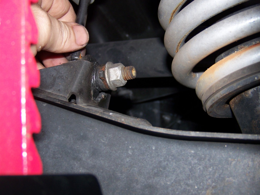

The main thing is, you won't see this anymore....

How is the endlink attached to the LCA? Is it another welded tab on top or run all the way through?

The top of the lower control arm is "open", the link is secured to the bottom of the arm. I can try to get another picture.

That's okay. I was just wondering for access reasons. It would be more of a pain to get to if they had another tab welded in there. Glad to hear that it runs to the bottom.
And since it's done this way, it may not be too much of a stretch for the '10-'11s to swap over to this. Unless you see a clearance issue?????

I snuck under the ZL1 and snapped pics that agree with those. So I guess the secret is out now.
I will change mine when they are available. The ZL1 LCA looks to be the same part nhumber going forward. It has the SS end link tab AND the hole for the straight down bolt of the new sway bar.
