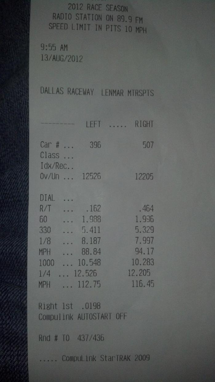

I drop TP to 25psi on my stock tires and give them a light haze burnout. Just enough to start the smoke.
A tune would do you wonders for your ET's. You probably don't want to do it but just sayin.
I usually launch between 2300-2500 and let out the clutch a lot similar to leaving quickly at a stop light
Also I feel your pain on the rev limiter at the stripe so I started shifting to 4th.
I'm still a beginner myself but talking to people here and at the track like you have has helped alot. Here is my fast slip from doing these. This is my fastest time to date. And a short video of beating a mustang lol.
I'm car #396
Hope some of this helps and gives you an idea of where you will be with a tune.

Thanks. Nice! You beat that faster Mustang with your RT! I need more practice. And I like your MPH. What are your mods? Stock tires?
At Atco you have to drive through the water. So I was spinning the tires for a second or so.
Good point about lowering tire pressure. I forgot to do that. And from doing more reading here you can get below 2 seconds on the 60 foot with stock tires.
No tune for now. Still trying to hang on to my warranty. I should be able to see times likes yours with more practice and a better DA.

Dropping easy weight like a spare or sub box is a good idea.
My mods are tsp long tubes, CAI intake scoop and washer relocation, Hurst short throw, muffler delete. And yes that was all on stock rubber.
The time slip pictured was me vs a cammed vette..the mustang races were in the video I linked.
