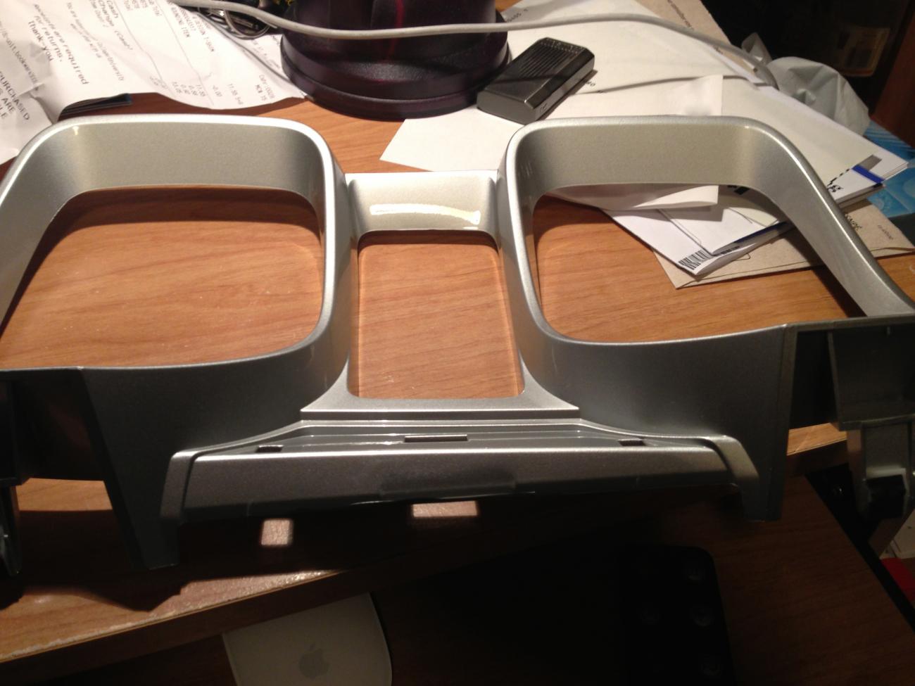

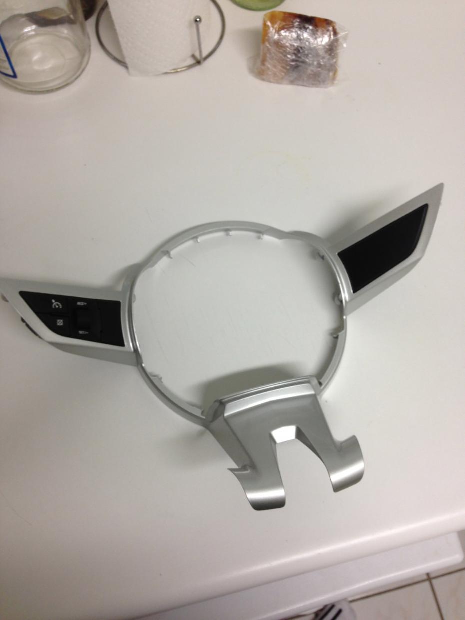

Just spent the last hour or so prying the trim off the interior of my Camaro so I could paint it and thought I'd post some pics of before/after. I only took off the steering wheel trim and the gauge bezels for now because I'm told doing the A/C vents requires the entire dash to be removed.
So here are pics before the painting and I will post pics of afterwards when it's done

I will be watching I want to do the same I was going to plasti dip with blue blaze and glossifier.
How'd you get steering wheel bezel off??

Carefully take the airbag off lol. On the sides of the airbag/horn there are two small holes. Push those in with a screwdriver or something, there's two metal "springs" in there.
Push that in then gently pull each side of the airbag off. Be careful cuz there's two plugs on the back that you don't want to rip out. Then just disconnect those and the bezel pops right off

Personal preference really but I painted mine because I wanted it to match exactly to the exterior colour
I'm sure you could get away with either really...
Sidenote: Just finished the last coat of clear now so here are some updated photos (2 coats adhesion promoter, 3 base coat, 4 clear coat btw)
First: before clear, Second: after clear.
I've also painted my key fob as well but it's not shown in the pictures. I'm letting the paint dry overnight and will do installation tomorrow
