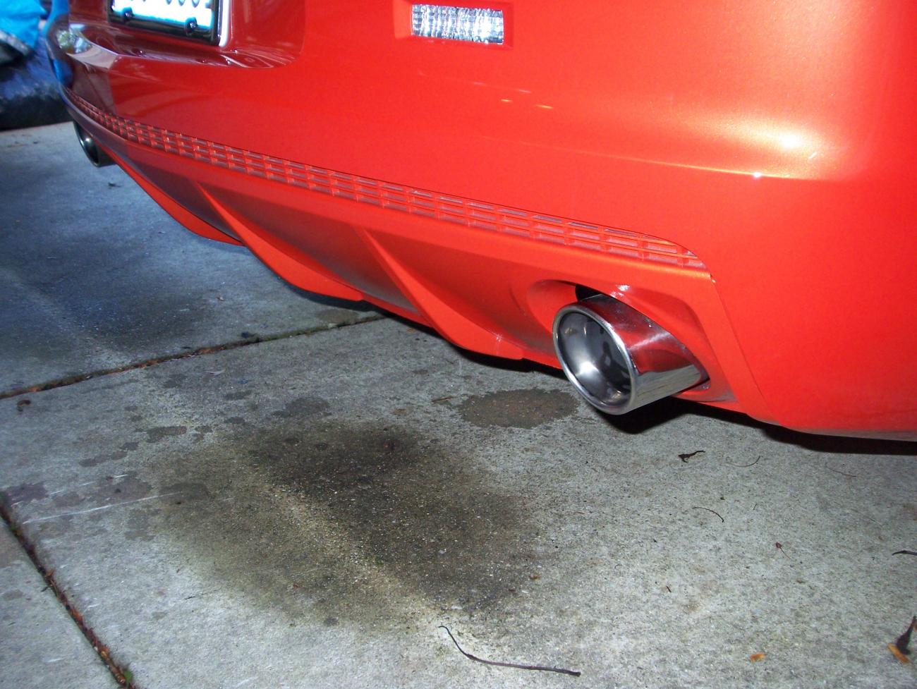

Here is a video of the custom assembled Flowmaster axle back system. We ran 2.25 s pipe from about the back side of the axle to the 9 inch single pass Flowmaster single pass race muffler #108385. We welded the 4 inch tip right to the outlet. I haven't been able to get it back on a lift for pics.

http://www.summitracing.com/search/b.../?autoview=SKU
I'm telling you,this thing is so deep it's incredible. It's sounds like a V8 Ferrari. I started with straight pipes but it was a little raspy. I'm going to wrap the muffler in ceramic blanket with SS sheild to remove the slight drone thats coming from the muffler casing.

sorry about the wrong part # it's that little 9inch unit.
The mufflers were 2.5 but we had tobend a tite s bend to get the muffler in the spot it isn't seen. Most of the system I've seen, the muffler is where the old muffler is. this gives a very clean look.
There's a little drone so I'm going to wrap them in ceramic blanket and a SS shell. The drone is resonating from the Muffler case.

That tight s-bend has got to be robbing some of your performance... but the result sounds awesome, I must admit. And being race mufflers, you really shouldn't have to worry about flow at all.

It's not as tight as it sounds. I'm going to try to get it on a lift today to get some pics. You're right, the mufflers are flow through with a small v-baffle. I think the open chamber muffler is what gives it the deep sound that usually is reserved for v8's.
