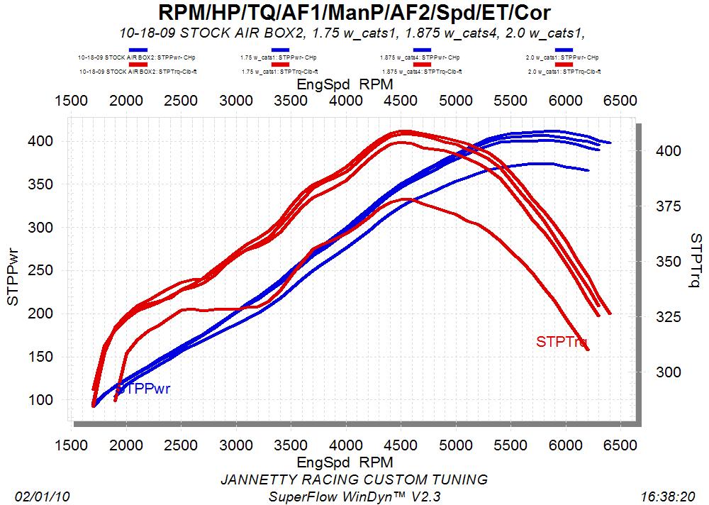

JANNETTY RACING HEADER TEST RESULTS
First let me say Thanks to Nick American Racing Headers for building us all 3 size headers, cat converters and test pipes, and related hardware.
Just to keep things Fair I Purchased these Headers for the Test.
Our Test Car is none other than, Bigdogs LS3 Camaro used in our CAI test.
This Car is 100% Stock other than the Headers installed for the Testing.
Stock Peak Numbers 373 RWHP 378 RWTQ
Stock Average Numbers I will post tomorow Forgot to print them.
1.75 long tube headers w high flow cats Peak 401.1 HP 403.8 TQ
1.75 long tube headers w high flow cats Average 281.2 HP 363.9 TQ
1.875 long tube headers w high flow cats Peak 406.8 HP 407.5 TQ
1.875 long tube headers w high flow cats Average 283.7 HP 366.6 TQ
2.0 long tube headers w high flow cats Peak 411.7 HP 408.9 TQ
2.0 long tube headers w high flow cats Average 288.1 HP 368.1 TQ
The 1 3/4 Headers did Surprisingly well.
The 1 7/8 Headers IMO are the best all around header.
The 2.0 Headers are neck and neck with the 1 7/8 but Slightly stronger from 5000 to 6300
In an all out racing application they would be worth the extra investment.
So Now it is up to you to choose what best fits your application.
Anybody want to buy some good used Headers
Some interesting tid bits of informations, the A/F ratios were unaffected by the headers or the header size changes, Ranged from 11.7 -12.3 through the pull, the fuel trims also remained constant from size to size.
We also Tested NO CATS and Guess What NO HP GAIN COULD BE MEASURED, ok I lied, 1 HP somwhere in the middle of the run, I think I farted near the air filter
All Kidding aside these cats flow like straight pipe.
And the Headers with High flow cats, Sound with the Factory Exhaust, Music to my Ears.
Here are the Graphs overlayed.

That sure is an ugly tq dip on the stock set up 2500 - 3500.
Did you use an ARH X - pipe? Or all stock after the high flow cats?

I don't understand how the 1 7/8 is "best all around header" in your opinion if the 2" headers had better average and peak numbers. Could you please explain? Thanks.
