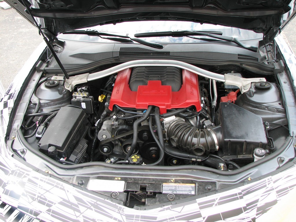

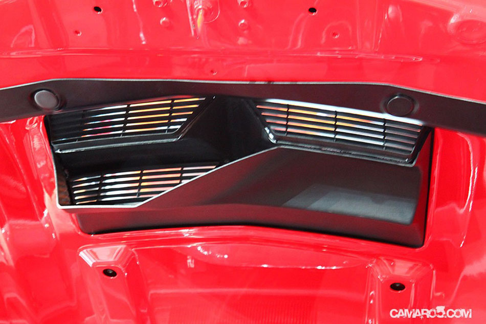

Just an observation. I know chevy does have this figured out already but it does make one wonder about that big gaping hole on top of the hood.
It will no doubt take in LOTS of water when the car is parked or being driven in a heavy thunderstorm. There is no way around it. Big hole, the water has to go some place. I suspect passing rain water would go straight to the ground as it passes in front of the engine inside the engine bay. But, I can see one side of the hood is sectioned off for what it looks like isolation to pass air into the breather duct work. The air intake tube looks to have two large holes to allow cooler air to partially inter the system. Maybe someone that has seen the mighty ZED EL ONE in person with the hood up can comment on this more.
I realize there are baffles, filters, and one knows not what from preventing water from entering the air intake system, but it don't take much water to make things act up as far as performance. Is there 110% guarantee while the car is running 60 MPH down the road in a heavy thunderstorm or even idling at a red light in a heavy thunderstorm there is no danger of water causing a performance issue? Cold 30 degree water being dumped right on top of an engine running 190 to 220 degrees temperature etc?
Those aren't holes in the intake tube. The intake is completely sealed up and no air can get in without going through the air filter in the air box.
Thanks. Its hard to tell by the photos...
Looks like we might be able to put this one to rest.
I guess we will know once we drive it in tough weather.
Thanks guys.

I think you'd be amazed at the validation exercises we put our cars and trucks thru --
In layman terms: We try to drown them by blowing water and ice and snow at them in massive quantities - for hours on end. While I have not seen any of the recent tests, I recall one with the 4th Gen SS where we blew snow into the front of the car at high speeds for hours - to the point where there was massive ice buildup - all to ensure that the mighty LS1 V8 would not ingest water or ice under severe conditions. THat's also why I cringe when I look under the hood at many Camaros and Firebirds - and see 'modifications' to the air intake.........

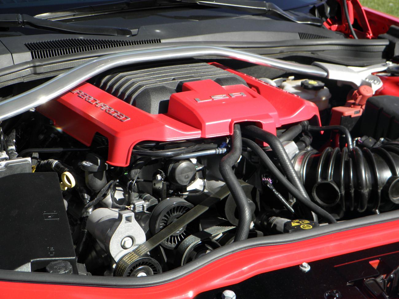

I think there are more recent photos of finished inlet hoses, but those are not holes. The MAF is just after tge airbox which means from there to the TB is completely sealed to the atmosphere, but not for PCV function.
ZL1 will have no problems with water injestion.
