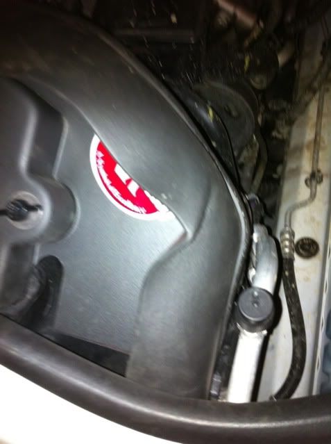

Before I even started on the VR I noticed immediately that the STOCK intake even had a gap before I even touched it. Here's a picture of the stock intake before I even laid one finger on it...

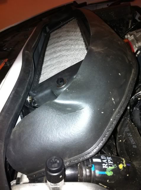

Now comes the scary part... This is as flush as I could get this thing and I hope it doesn't cause issues. Steve, if you're reading this please let me know if I need a replacement or if this will be ok?
Here's a picture of me trying to get it fitted.. I think that's as close/tight as I could get it..
Ahh yes.. almost forgot about this picture. One of the screws to hold in the MAF was bent... I lost the other screw taking this picture (it rolled down the front of the car and landed behind the grill) so I just ended up using one of the stock screws that held the MAF in.
Close up picture of it after I have it tighten down.. is it on? or not?
Driver's side VR has some overhang that looks a little ugly...
Here's the finished? product.....

Steve (sales@vararam.com), if you're reading this, I know you said to call if we have any issues but for me it was a matter of getting this thing on before it got dark so I had a drivable car to work in the morning.
I'm going to keep an eye on it for a few days to see if it keeps moving or not. But with the picture above showing the big gap is that going to be ok?

hey man glad you got your VR. AS for the GAP, i personally think thats too big. Im sure vararam will send you a better fit belly.

Please call us at 866-507-2648 !!!!
The angle is OK, but because your motor is twisted ,we will custom cut a lower for you for a more flush mount.

Just popped the hood and checked and it doesn't look like it has moved since I first drove the car for 2 miles yesterday and I drove it kind of hard today for ~30 miles. My key fob only fits between if I cram it but there's still space there. I also haven't taken it off to adjust it like I was going to do today but buddies at work wanted to go out for beers after so I got side tracked, tomorrow is poker night and I work Saturday so maybe Sat afternoon/evening I'll redo it.
Best thing is I don't think it's moving so I must've closed that gap a little more than what the picture shows prior to the red hose going on.
