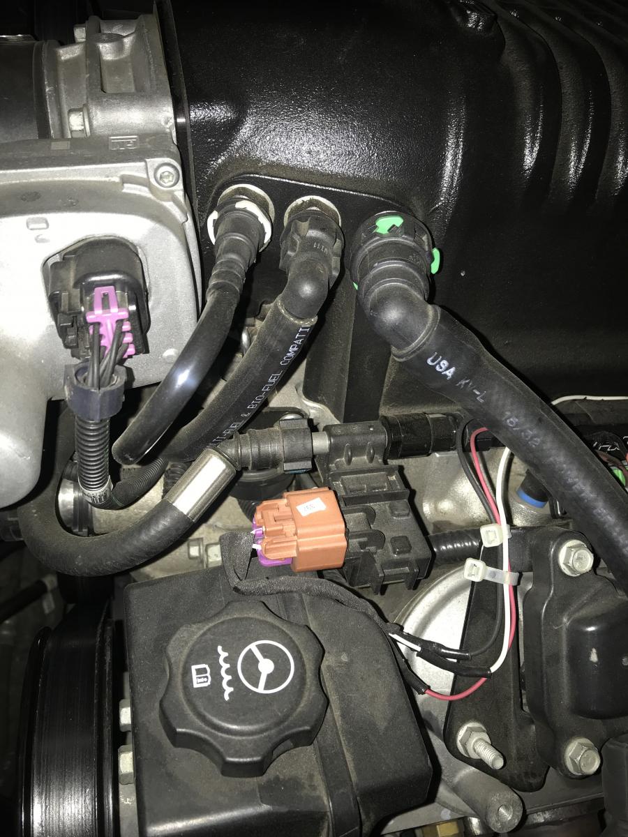

That's nuts to run plastic sensor that close to the headers, but whatever.
There's many ways to run a stock GM Ethanol sensor. Here's mine.
I might have $65 invested.
BTW, normal Michigan gas is around 10% Ethanol.
Attachment 966204
Just curious, do you run a modified FPCM with your setup? Buy it? Or mod it yourself?
