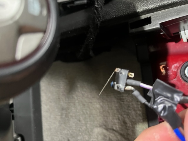

Key stuck in ignition
So I researched the crap out of this. Installed a new ignition switch and didn't work. Found a useful video the take apart the shifter trim to get to the shifter switch.
https://www.google.com/search?q=cama...id:59kfjhXDF0Q
Problem for me was the damn 25cent Chinese shifter switch is bad. I searched all over and can't find a replacement switch and it does not have a part number. As you can see I jumped the 2 wires but I don't like rigging things like this, especially when I give this car to my daughter. Started happening around 40,000 miles. Key comes out all the time but issue is you can be in any gear and remove the key. Only good thing is once in park and key is removed shifter stays in park. Was anyone able to find this piece of crap switch? Only other option is to spend $165+ for the entire shifter but a buddy of mine did that and 2,000 miles later he had the same problem.

Thats called a limit switch/micro switch you will probably have to modify one depending how it mounts. Don't worry about AC or DC ratings just amps.
https://www.amazon.com/MXRS-Hinge-Mo...ps%2C97&sr=8-4
https://www.amazon.com/dp/B07P4CJ8TV...1-df67fc737124
