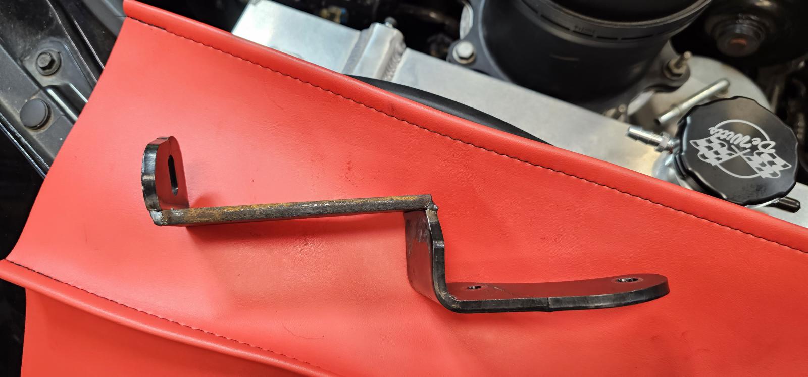

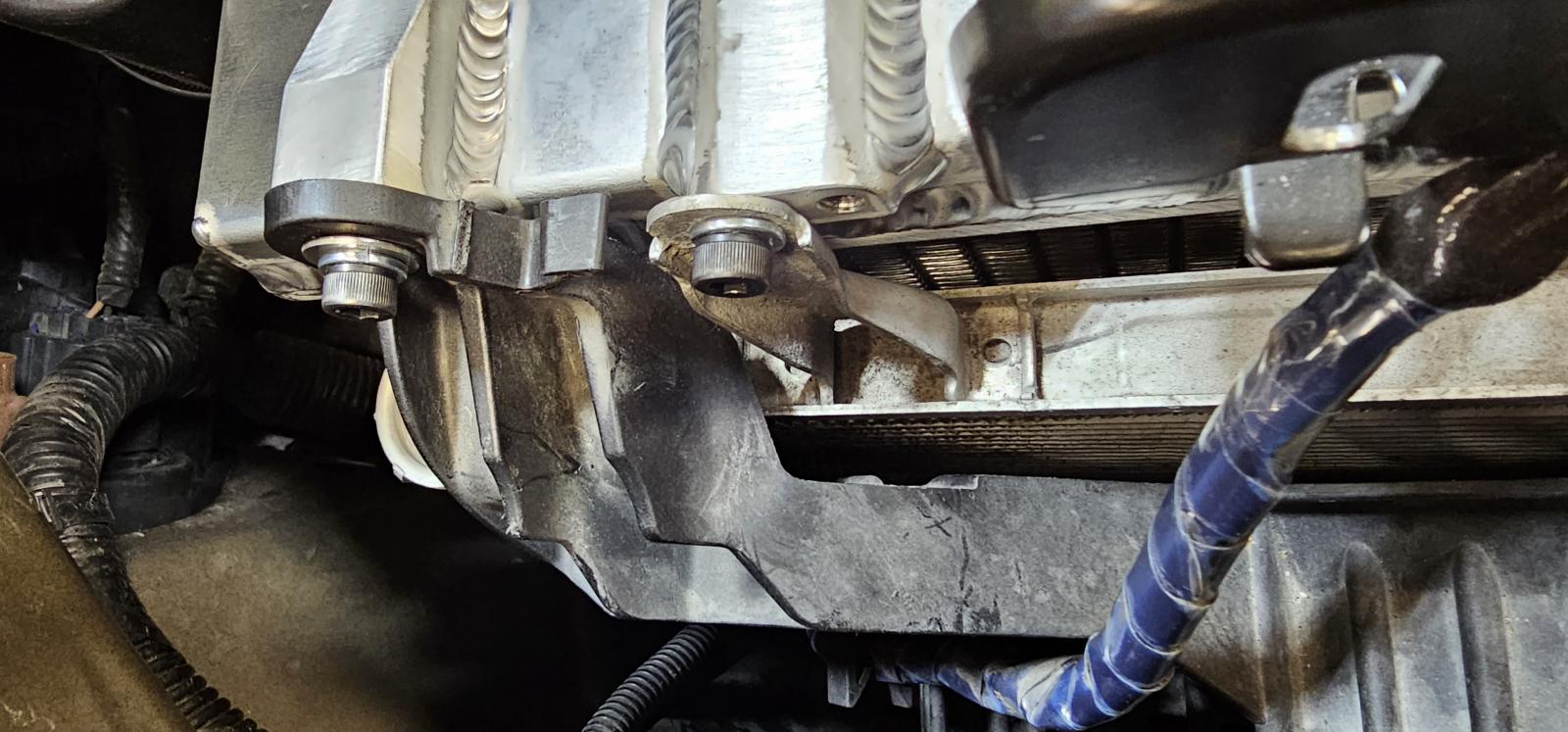

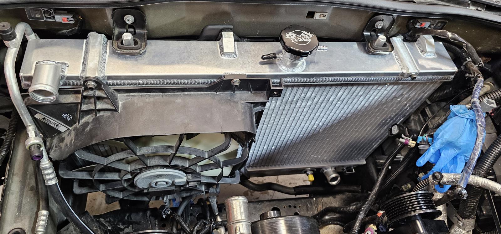

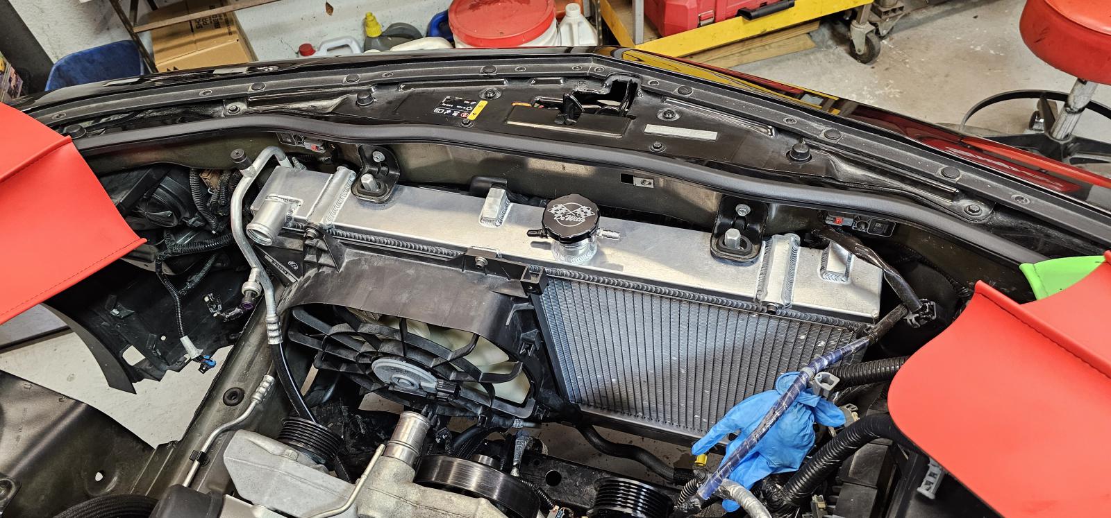

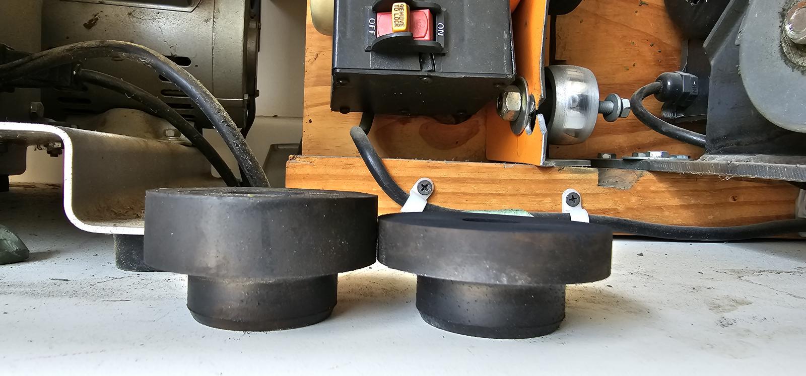

Here is what I did to fit my DeWitts into my Z/28. Please remember what worked from me may not work for you as we live in an imperfect world where several things being off by 1/16" from OEM could become a 1/4" alignment issue at the end of the line. It is what it is and that is OK and to be expected.
1. I sanded down both the bottom and top rubber isolation mounts by 1/2 of their OEM thickness. If you sand / cut down the lower isolation pads to much you could run into hose rub issues against the frame cross member for all hoses across the bottom of the radiator, but more so the hose leading to the oil cooler mounted to the engine block on the driver's side.

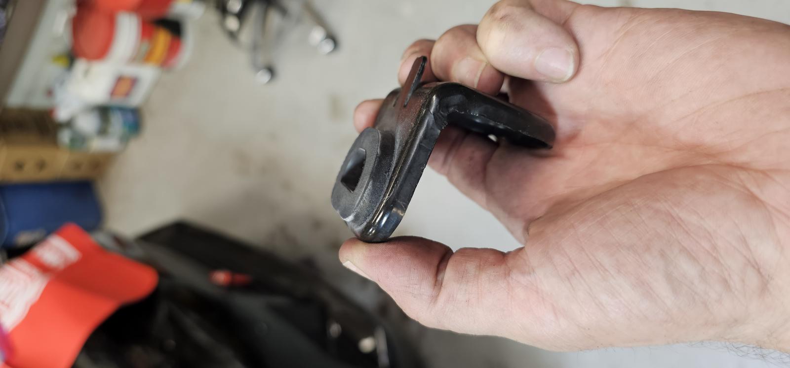

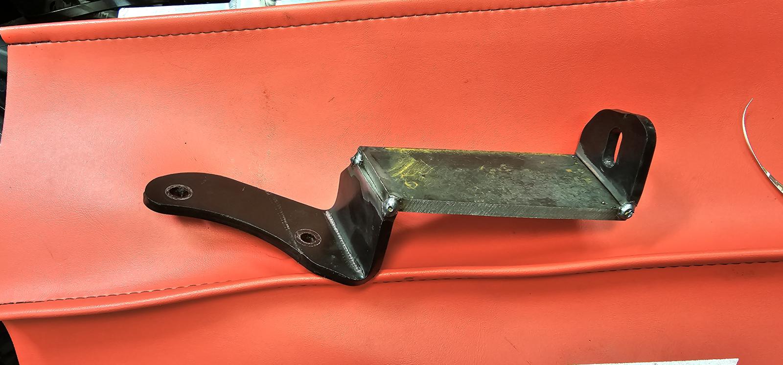

2. I modified the upper dry sump bracket, this involves first bending /beating with a sledge hammer the bracket in a vice to 90 degrees from its OEM 70ish degrees bend as it leaves the sump tank mounting points, cutting the mounting tab off the OEM bracket where it mounts to the core support and welding it back onto a new extended piece of steel to clear the new radiator depth. The OEM dry sump upper bracket is MEGA overkill in robustness but it was there for use so I just matched the material with available steel scrap I had on hand.

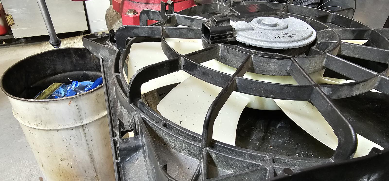

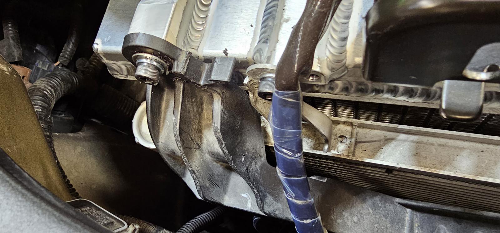

3. I clearanced / sanded down with a dremel 2 shroud fins on the front fan housing to clear the core support and 1 shroud fin on the rear fan housing to clear the auxiliary tank on the dry sump.
4. I clearanced an accessory mounting tab on the core support so the OEM auxiliary radiator upper hose would clear when taking the radiator assemblies in and out of the car. You might get lucky and not need to do this.
I am in the midst of a new engine build / install so it will be awhile before I can get around to testing the radiator on track.
You can get this job done in a weekend if you are handy with the wrenches and can measure, cut and weld. I have the hood removed off the car, have it on a lift as you will be working from the top and bottom. I left the front facia on the car as I had no desire to remove it an open another can of worms dealing with body work / alignment issues or monkeying around with fender flares and reattaching them.
