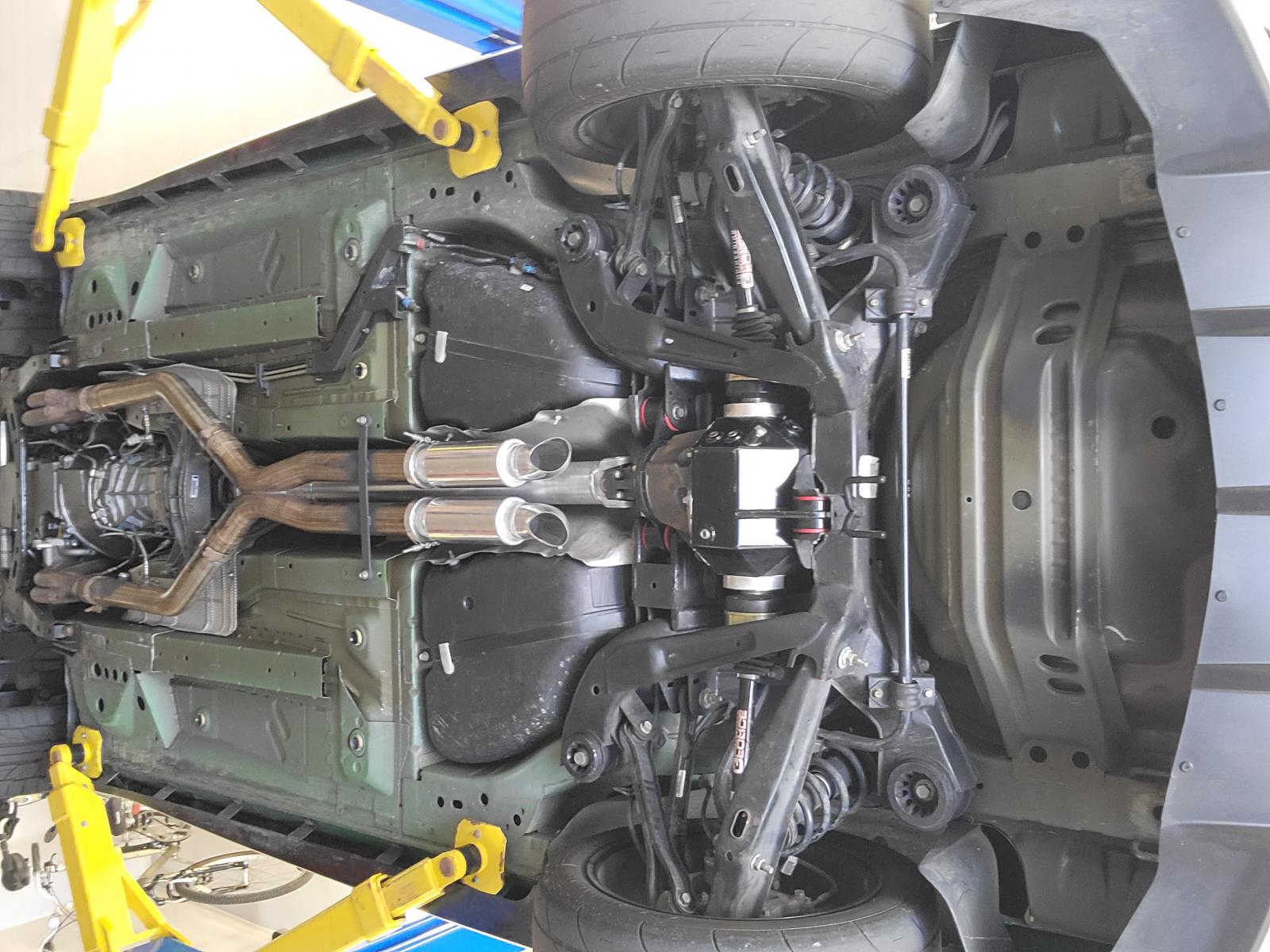

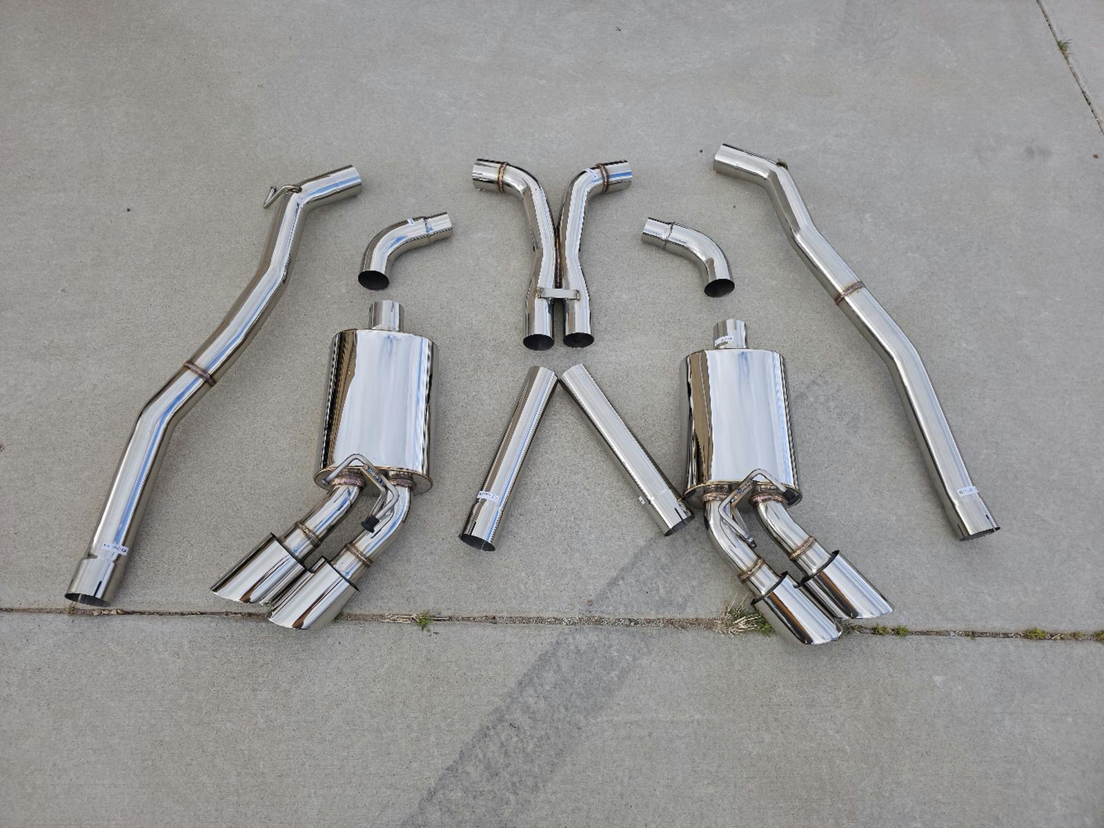

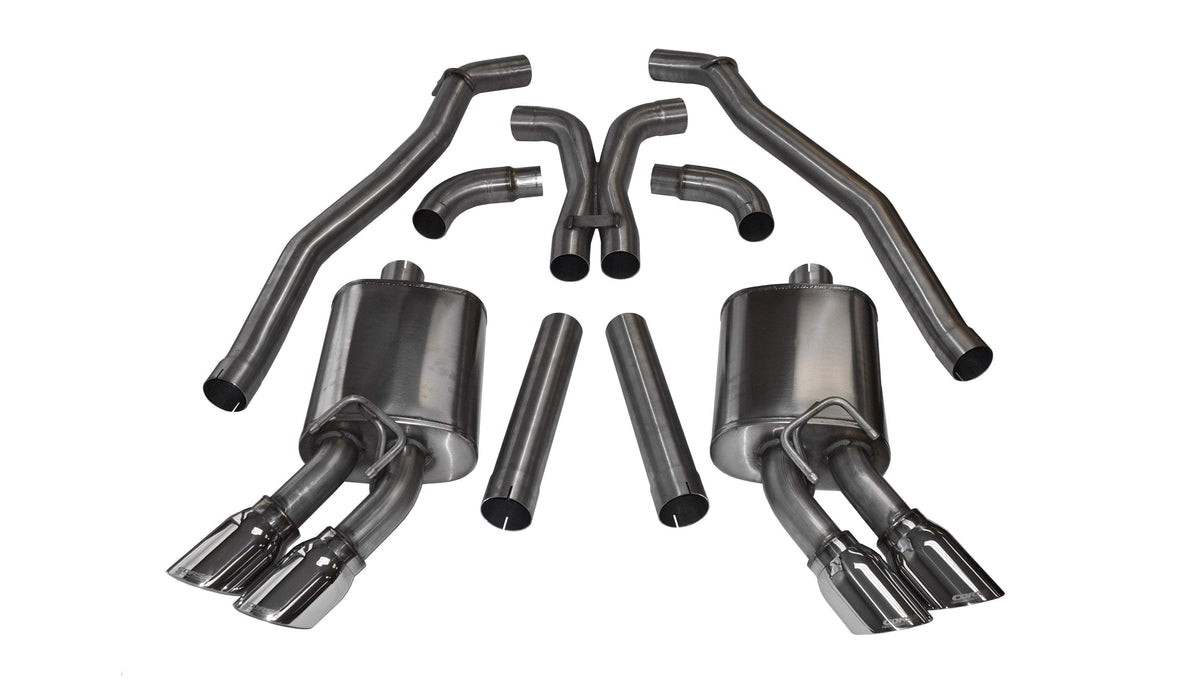

I was looking for a cheep straight pipe exaust on ebay and I found one called a maximizer exaust. I also was looking at a corsa cat back and I realized they looked the same. I just said screw it now bad can it bee for $216. After installing it and I expected it to be like the gates of hell opening, but I was shurely disappointed. It was less quiet than my closed valves factory NPP exaust, mabie I am just deaf after running open headers for 2 weeks straight as a daily. it sounds great couse of the x pipe but its just quiet, its like I put factory ss mufflers on. Anyone else have this same problem. Im going to post pictures so yall can see the diffrences. What exaust should i go with at this point, what im thinking is just go full straight pipe. I hear some people say they sound like shit straight piped. Corsa sounds great but burning $2300 dosent sound great. I genuinely do not onow what to do now id appreciate the help!!!

I just decided out of spite to unbolt the mufflers and leave them hanging to see what the car would sound straight piped and it sounds wicked, I might just take the mufflers off and get some axle back muffler deletes and bolt them bad boys on, because this sounds crazy.... heres video proof!!!!!

It might just be that mufflers of that size, might be too quiet for you. I have a Borla Touring catback, and Speed Engineering 1-7/8 headers (with off-road connection pipes). The 2.5" catback, with a non-resonated x-pipe, is loud enough for my taste. Anything smaller for rear mufflers, and I might be considering glasspacks or resonators to be put in the mid pipes.
I'm currently about to get a second x-pipe welded into my mid pipes. I don't think it will change the sound or volume too much; but supposedly, it makes the tone a little deeper, and the volume might get a tiny bit quieter (somehow).
You said you have eBay long tubes, which are usually closer to having 1-3/4" primaries. It's not a huge difference IMO, whereas 2" long tubes would be louder than the typical 1-7/8" long tube piping size. I personally wish I had gotten 2" long tubes, but the fitment and potential "modifications" needed (lots of hammering), kinda put me off from getting them...
Also, you might be interested in customizing your exhaust, in a fashion similar to the Mach Solo catback design; which has an x-pipe mid muffler, to straight pipes. It's probably along the same setup, as having a non-resonated x-pipe in your mid pipes, and running decent fiberglass-packed rear mufflers/axleback. I'm still surprised that the 3" catback is actually too quiet for your taste... Usually, they drone a lot more than 2.5", and are somewhat hard to tame.
