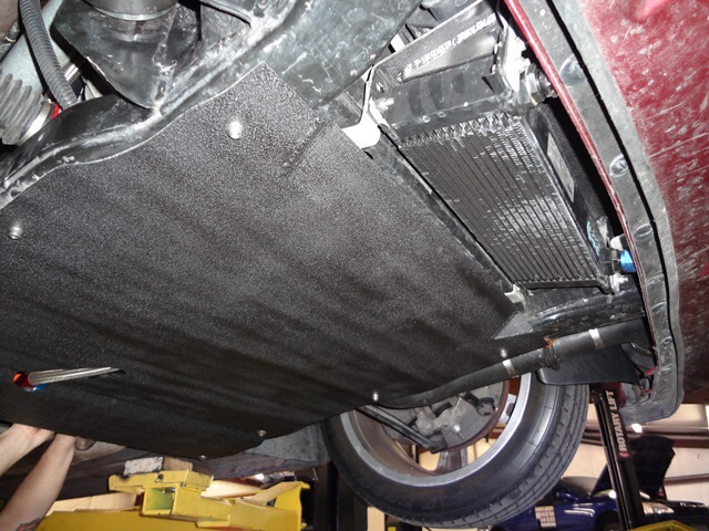

We borrowed a ZL1, threw it up on a lift and removed the belly pan. We traced it out on a sheet of aluminum, and cut it out. We reinstalled the original one and then started bending and fashioning the new one to fit my car. I built a frame work for the new Setrab cooler from the existing mounting holes and added a couple for firm mounting.
From there, we plumbed the new remote oil cooler, and not wanting to stack it in front of the intercooler/radiators, we laid it flat and integrated it into the belly pan we fabbed. With the way it was integrated, we did get a small amount of air forced under the car, as the cooler scrubbed air from the lower grill opening, but we more than compensated for that. We ended up cooling the oil with ambient temperature air and I saw a marked reduction in oil temps.
Please excuse the dirty under side of Brandi...
