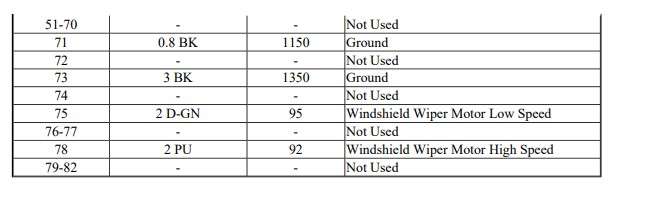

My docs say that X1 Pin 7 is Low Speed fand and 58 is High Speed, so that's another discrepancy.

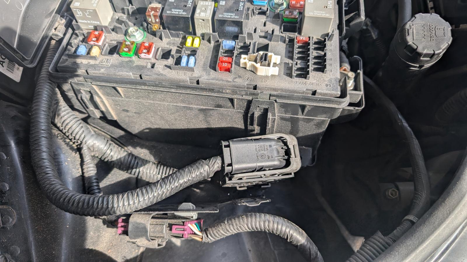

How do I take the Fuse Box apart? I'd like to do a visual inspection of the underside wiring.
The 2 plugs next to the fuse box on the passenger fender side, what are those plugs called?

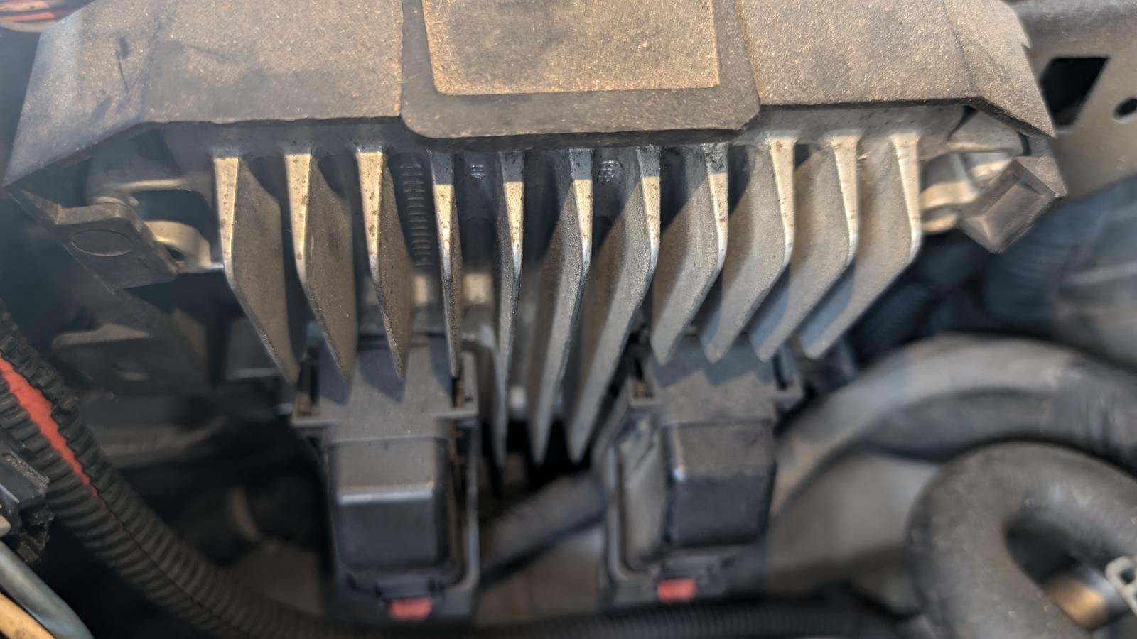

If I am not mistaken, all 5th gen V8's have the E38 ecm with X1 & X2 plugs. The V6 cars have the E69 unit with the blue plug. I could be wrong though. I will dig through Alldata some more.

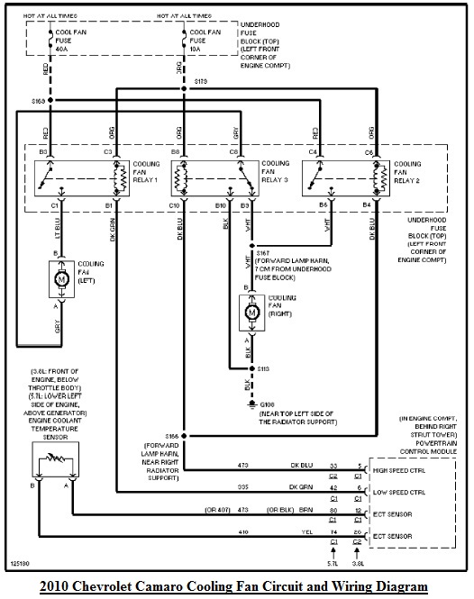

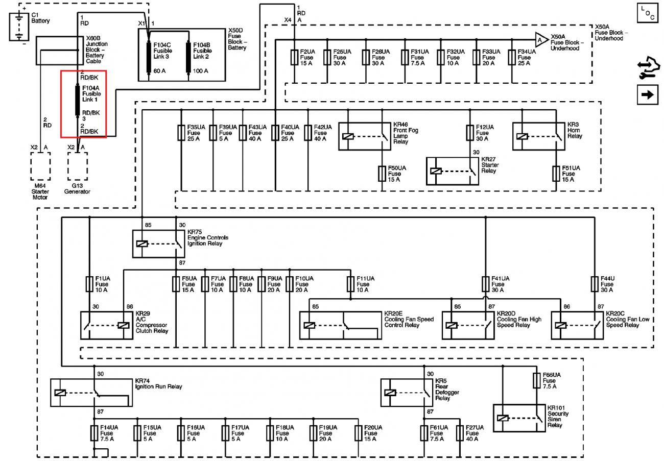

I seem to have wiring diagrams, but it's unclear which plug on the PCM and Fuse Block is which.
Attachment 1171067
Attachment 1171068
Attachment 1171069
Attachment 1171070
I was having trouble getting photos inserted.
So which harness at the PCM would have the fan wires?
And which one at the fuse block?
Thanks!
-KP
I would still like to know what the plugs next to the passenger side of the fuse box are?
-KP
