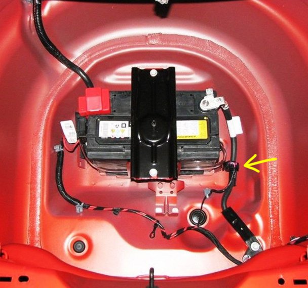

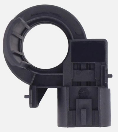

Has anyone ever thought if it affects battery charging/voltage,when there are 2 negative cables in parallel,but only one battery current sensor ? ?
The sensor is mounted directly to the battery post of the car. It doesn't care about any connections between the battery and the car. Not to mention the sensor is only reading the positive side, not the negative side.

Isn't it located 6-7 inches from the negative post.
