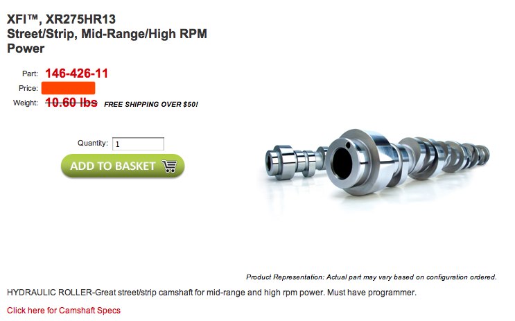

I have an Ls3 with LT headers, hi-flow cats, 3in exhaust, intake, and 160 thermostat. I want to do a cam, something that will give me good performance gains and lopey sound....something with good drivability, so not too aggressive. I called comp cams and they told me to use PN-146-426-11. Is this a good one or is there something better for what i want ?

Please throw the specs of that cam up here so we all do not need to run to Comp Cams website to look them up. You will probably get more responses to your question.

Here are the specs Comp Cam provided you. I'm sure some forum members can comment on the selection.

(227/243 .614/.624) 113 LSA....these are the specs to the new cam that i am considering, any thoughts ?

Comp is correct that is a good mid range cam, which will still retain average drive-ability, yet will denote an audible cam sound.
We use a similar ST.2 cam in our builds with similar client requests
230 / 236 .590 .600 114 - this cam yields a good cam sound, an increase of 45-50 horsepower and good NO SURGING drive ability.
Good Luck
