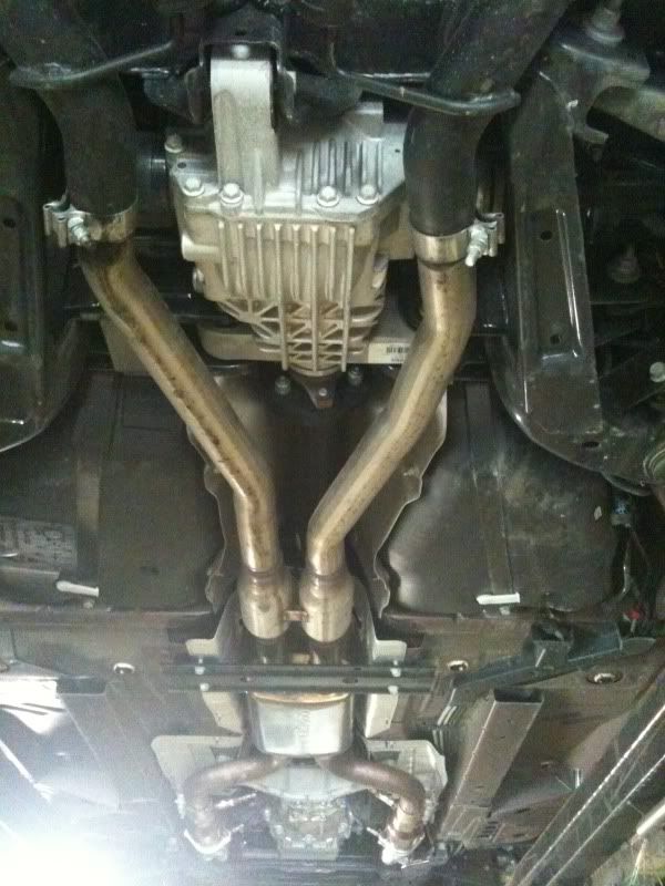

Old 10-12-2010, 05:05 PM   #8
KMPrenger
KMPrenger's Avatar
Posts: 13,967
On my car:

Old 10-13-2010, 01:04 AM   #11
VR Baron
SoCal Camaro5 Race Team
Drives: 2021 Shadow Grey Camaro 2SS 1LE
Location: SO CAL
Posts: 14,367
Originally Posted by KMPrenger View Post
On my car:
Hey KM Thats the one I have but I have forgotten which one My shop put on Isn't that the 2.5" unit? The head pipes and the pipes to the stock resonaters are 2.5" and the after pipes are only 2.25" and the pipes fit into the x pipe. maybe the internal bore is only 2.25"? I know the 2.25" mufflers i have are 2.5" internal but is the x pipe?
Let me know?
Thanks Blackbee
