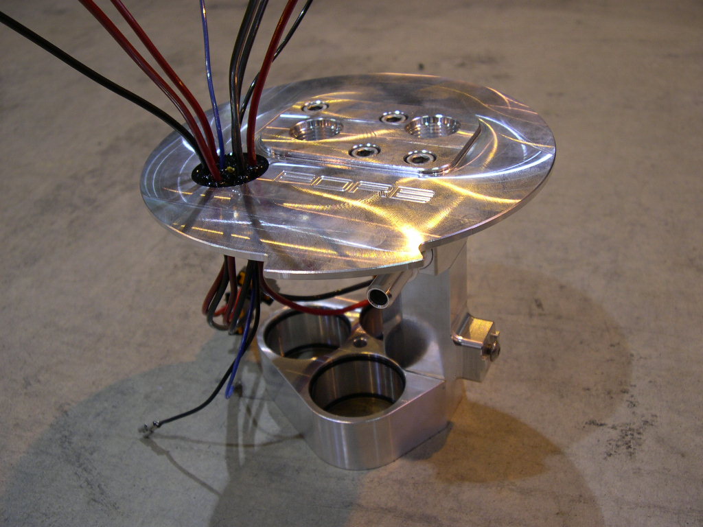

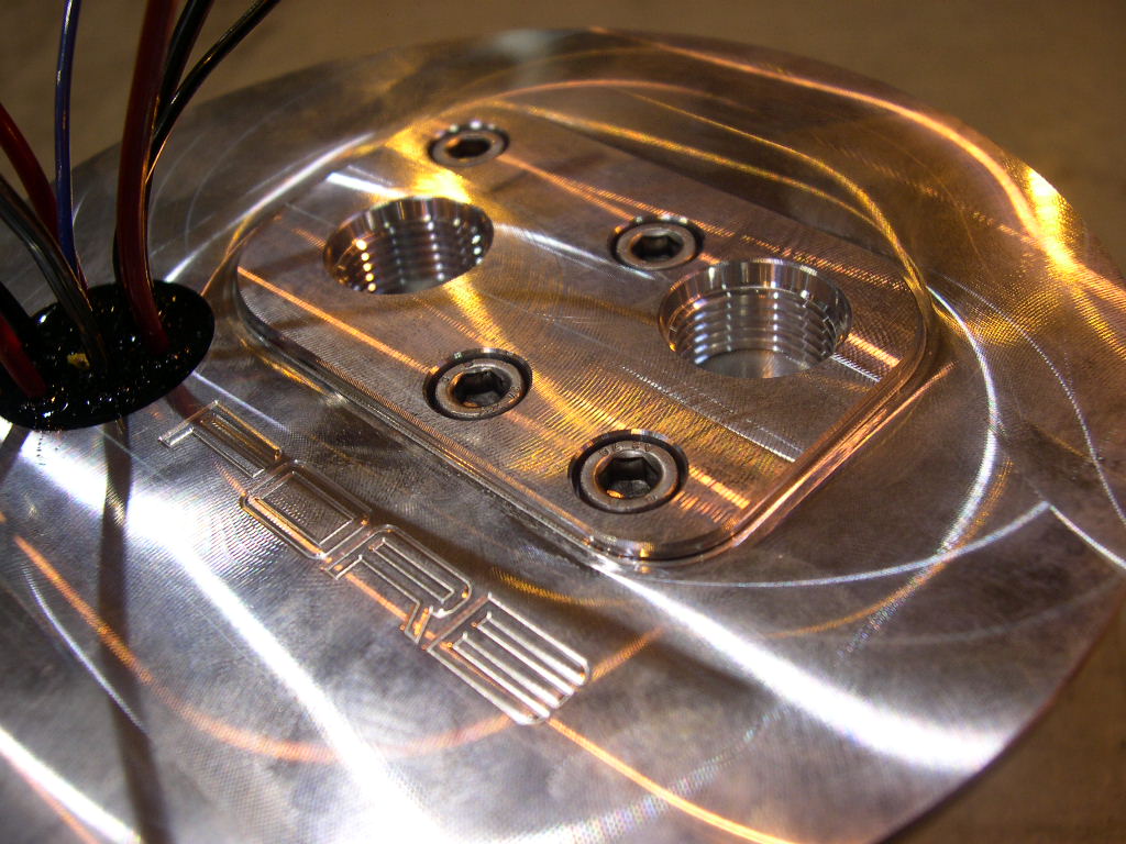

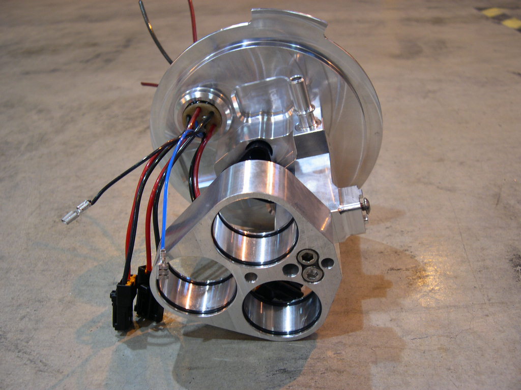

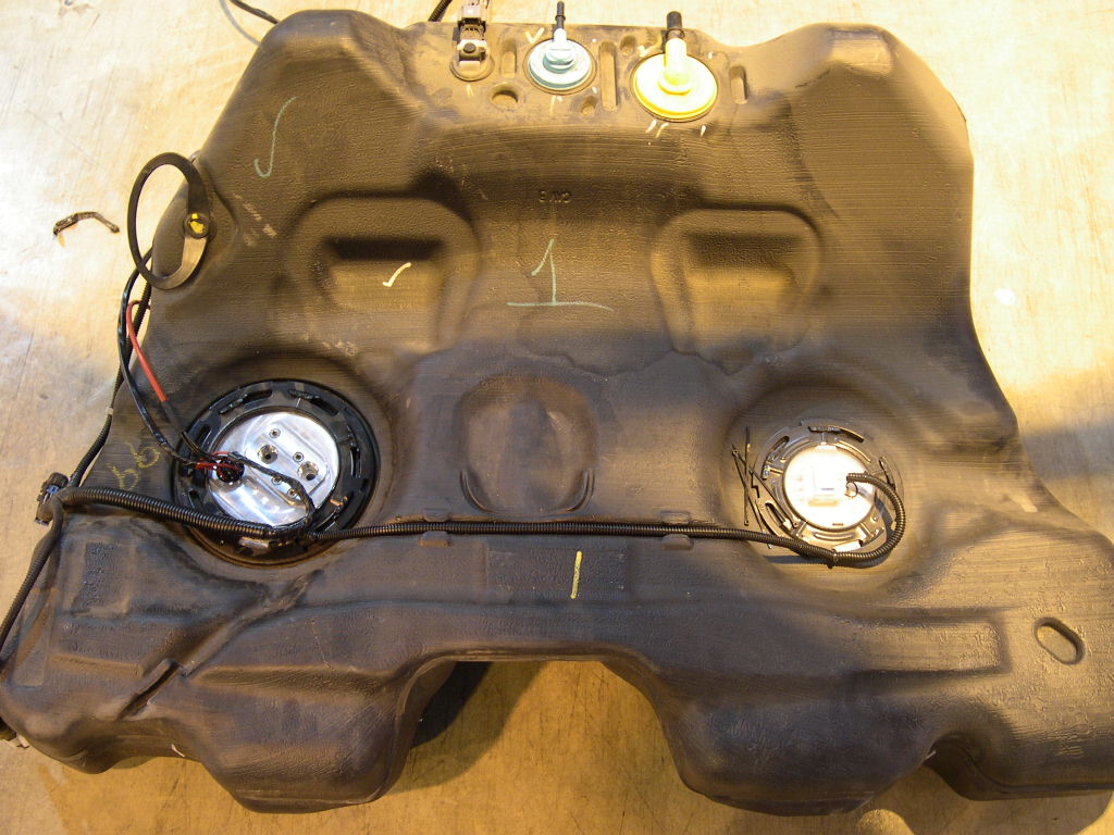

Well we have received our prototype and test assembly for our TT 5 gen project here at the shop.
We will be releasing a full install kit including all the necessary components to bolt this fuel system into your Camaro with proper wiring relays, and hydraulic pressed Teflon fuel hoses for those using either petrol or ethanol.
So far everything with this system has gone to plan and fitment is very good (and this is a simple system that most moderate level technicians should be able to handle especially once we release the kit and instructions). This particular project will clear 1000 wheel horsepower so it will be a good benchmark for the triple systems capacity.
More information on this project is also on our blogspot page http://ipsdomestic.blogspot.com/2010...-fuel-hat.html
If anyone has questions or would like to get in on a pre-order please let me know
